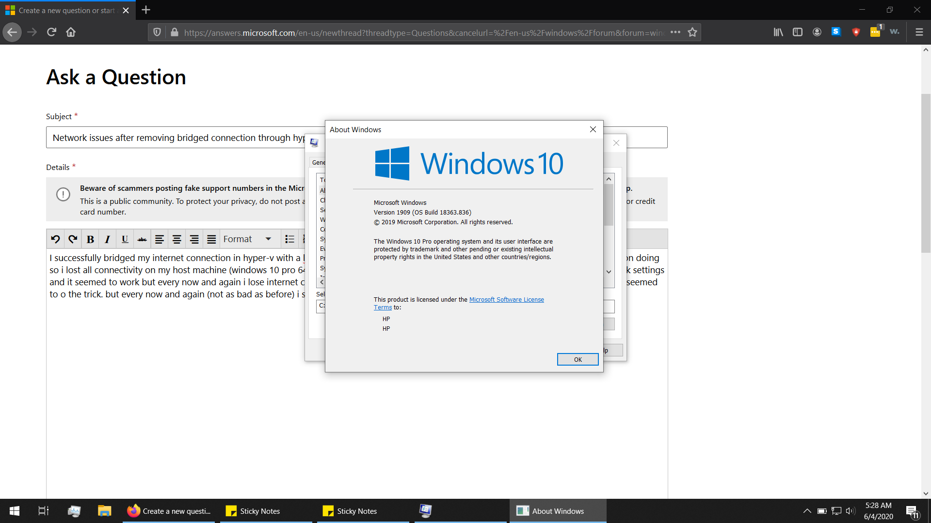

  1. Network issues after removing bridged connection through hyper-v
    I successfully bridged my internet connection in hyper-v with a linux mint virtual machine. i then decided to remove the bridged connection. upon doing so i lost all connectivity on my host machine windows 10 pro 64bit. I restarted the host machine and still no network connection. i reset network settings and it seemed to work but every so often i lost internet connection. i decided to do a system recovery fresh factory default install and it seemed to do the trick. but every now and again not as bad as before i still lose internet connection.
    Network issues after removing bridged connection through hyper-v 9e8102bb-6934-44f9-85be-b8257113ed37?upload=true.png
    ctr1_alt_del, Jun 4, 2020
