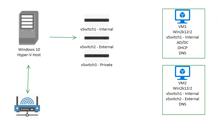

    Hey all,
    I have a weird issue with my Windows 10 Hyper-V that I do not have with other machines. Let me explain below:
    I am following this guide:
    Step by step guide: Configure a test lab to deploy Windows 10 https://docs.microsoft.com/en-us/windows/deployment/windows-10-poc
    The lab is going fine. Following the instructions and im moving alone learning a new thing here and there.
    With this lab i created 3 virtual switches:
    Internal vSwitch
    External vSwitch
    Local vSwitch
    There are 2 server VM's are running:
    VM1:
    Win2k12r2
    Internal vSwitch
    192.168.0.x
    DC, AD, DHCP and DNS servers
    VM2:
    Win2k12r2
    Internal vSwitch
    External vSwitch (to download updates & other resources)
    DNS, MDT, SCCM
    So like i said, everything is dandy except for 1 thing, whenever i shutdown VM1 my Windows 10 Hyper-V host loses connection to the network.
    The virtual network is on 192.168.0.x and my physical network is 192.168.1.x
    This is the ipconfig /all from the host machine: https://paste.ubuntu.com/p/StPNZYnBYK/
    This is the ipconfig /all from the VM2: https://paste.ubuntu.com/p/QzSZjFGknF/
    This is the ipconfig /all from the VM1: https://paste.ubuntu.com/p/SKHRHVb9z9/df
    Any thoughts of why the host machine loses connection when i turn off the VM's would be greatly appreciated.
    Network issues with Windows 10 Hyper V and VMs b42a2633-f569-401b-886c-43bbff319f81?upload=true.png
    Nizar I., May 7, 2019
