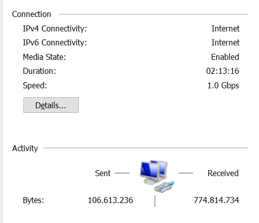

    Here is the network:
    Network problems - ethernet over powerline 5caeb02c-ab24-4769-a715-b3f389cddd7f?upload=true.png

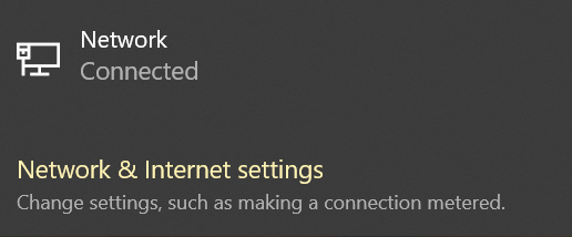

    Network problems - ethernet over powerline 7b976fd9-026c-4794-bebd-b8b6dbc5469e?upload=true.png

    pinging to a website also works while I'm connected to "Network" network.
