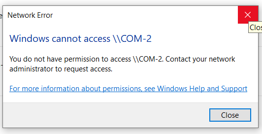

    I've windows 10 pro. version 20H2. I'm having issues in Network Sharing. It's like i can access few nodes on my network but those few including every single node on my network can't access my laptop. The error is in the below pic :
    Network Sharing Issue bc687e7e-1217-4046-a165-37e6d2dc883a?upload=true.png ​
    When I try to access some node Namely COM-2 i get this error and same error appears on to every single node on the network that tries to access my node.
    I've done the following things :
    1. turned on network sharing
    2. turned of windows and antivirus firewall
    3. turned on services in services.msc fdPHost, FDResPub, SSDPSRV, upnphost, PNRPsvc, p2psvc, p2pimsvc, Netman and set them to automatic
    4. enabled/disabled password protected sharing
    5. turned on SMB 1.0 and SMB Direct
    6. even changed pc name thrice
    Please help me someone. THIS IS REALLY ANNOYING & makes my work suffer a lot.

    We see that you are having issues accessing the shared drive on your network. To assist you further, kindly answer the questions below:
    • Have you made any changes to your computer or network prior to this issue?
    Regards.

    Thank you for your response.
    We would like you to perform these steps and check.
    Step 1: Enable NetBIOS over TCP/IP on Windows, follow these steps:
    1. Click Start, and then click
      Network
      . (Or you type ncpa.cpl into the search box, and press ENTER).
    2. Click on the Network and Sharing Center, and then click Manage Network Connections.
    3. Right click on the Local Area Connection or the connection you are using, and then select
      Properties.
    4. Select the Internet Protocol version 4 (TCP/IPv4)
    5. Click the Advanced button under the General tab.
    6. Click the WINS tab.
    7. Click the Enable NetBIOS Over TCP/IP button. Click
      Ok.
    Step 2: Access shared drive using IP Address.
    Try accessing the shared drive by using the IP Address of the other PC and check.
    Step 3: Temporarily Disable Firewall and check. Disable Firewall one computer at a time.
