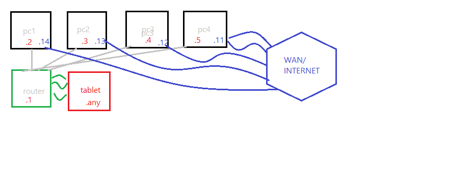

    I have a network drawn out like this. The problem is 'tablet' has no internet. Tablet can connect to wireless on the router and then access the network pcs by IP. But the tablet is on android, and can't be configured like windows. How can I get a connection like WAN/INTERNET being fed into the router switch and then broadcasting to each connected (wired/wireless) PC or tablet? Bridge mode?
    Can I use ICS and then replug in PC1 to the router, then router should broadcast with internet? I haven't tried it yet. This is only a problem due to a employer's bad programming skill. I know there are many configs and ways to 'get internet' and fix these things, but in this case I want the router to broadcast internet (no wired WAN input). I want the wired ones to keep their static IPs.
    I can also try to put bridged mode on each the PCs (the wifi with internet and ethernet with no internet) and then assign new static ips, hopefully they can still communicate with each other after that. I will try these and hopefully quickly see what happens. If not I need help.
    Blue and green wavy lines are WIRELESS. Other lines are ETHERNET. The set up works fine but not for the tablet; it can either connect to WAN and then can't access the network PCs or it can connect to the router with no internet. Help is appreciated.
