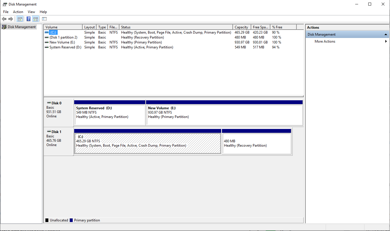

    Setting up new build with two SSDs. 500 GB Samsung 970 EVO m.2 is supposed to be for OS and programs. 1TB Crucial is supposed to be for file storage. After noticing the System Reserved on the 1TB drive, I disconnected the SSD and installed Windows with only the 500 GB attached. After completing all updates and installing Microsoft Office, I reconnected the 1TB drive and still see what is shown below.
    First and foremost, I wanted to know the difference between the System Reserved and the Recovery Partition. I would have expected to see the System Reserved to show up on the 500 GB drive after the re-install with only that drive connected.
    I've been told I may need to wipe both drives and start over, but I'm unsure the best way to do it and I don't want to harm the brand new SSDs. I'm also wondering if it's even necessary considering I already went through the process of installing Windows and Office with only the 500 GB drive connected.
    I am completely new to this and trying to learn, so any length of detail you could provide in your suggestions would be appreciated.
