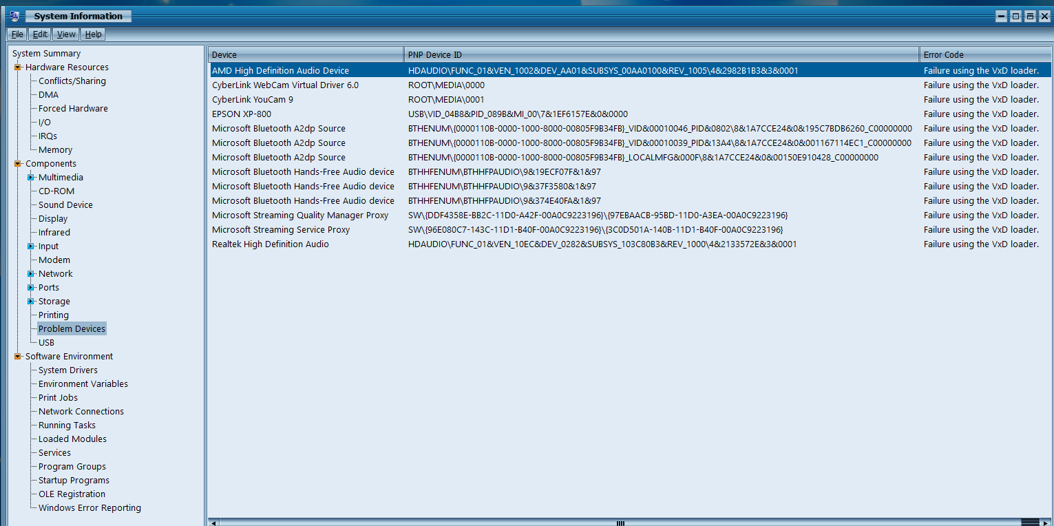

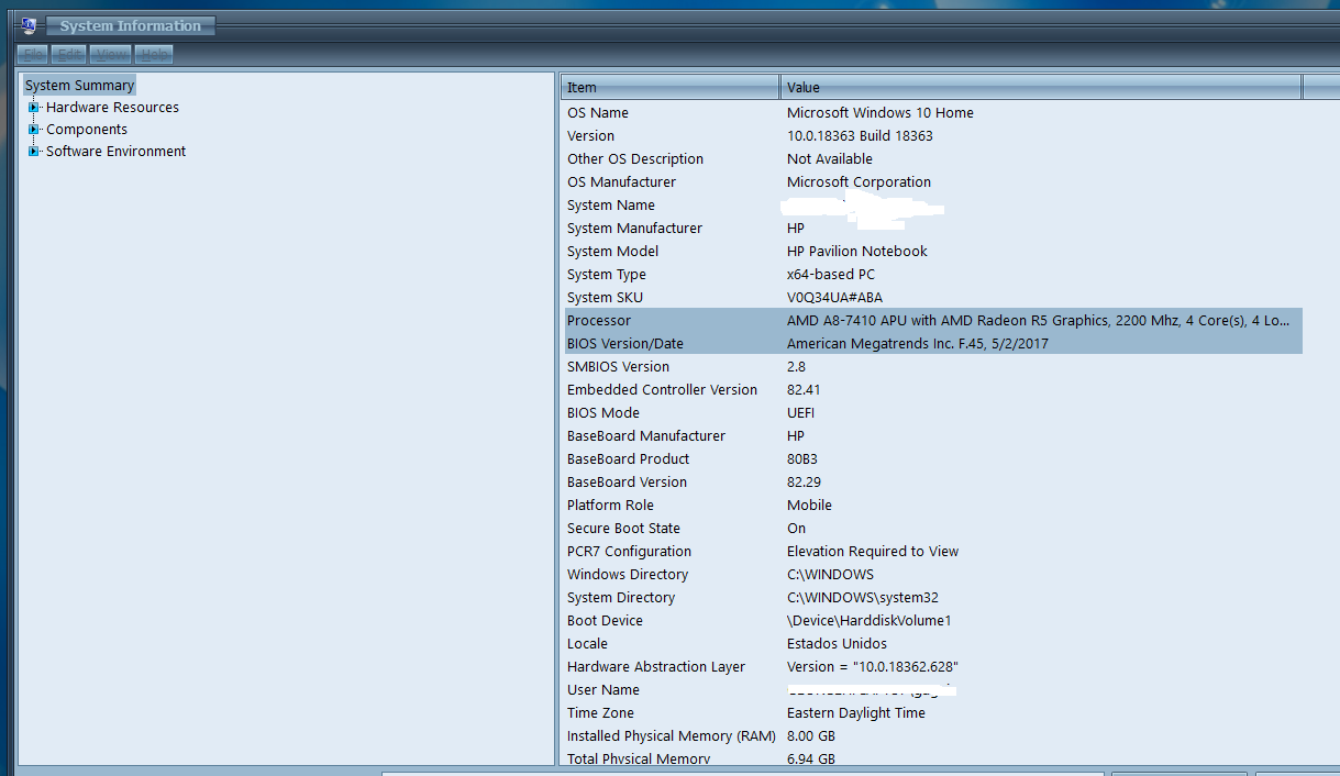

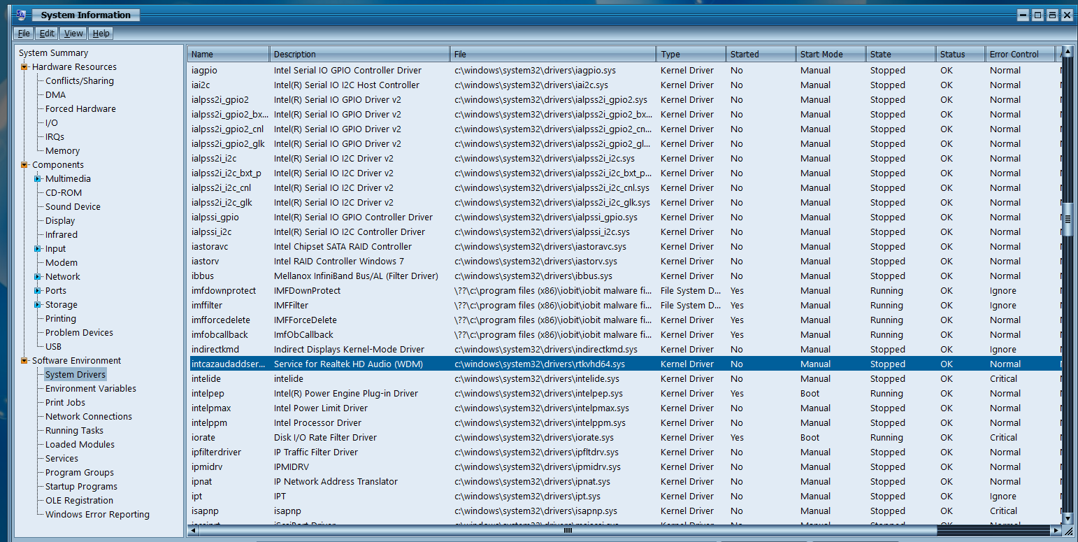

    NO AUDIO OUTPUT DEVICE INSTALLED WINDOWS 10
    Hi. I'm contacting you guys because I have nothing left to do to fix my HP Pavilion laptop. Couple of weeks ago, after an update from Microsoft, my laptop lost its audio. I have the sound icon on the taskbar in a red circle with an X. When I hover the mouse over it, I get
    the message "No Audio Output is Installed", and when I click on it the window of Playing Audio comes up with Detecting Problems.
    The result after checking audio device driver is . When right-clicking on the sound icon I get three options: Sound Settings/ Speaker Setup/ Troubleshoot Sound Problems. On Sound Settings I get Sound with
    Output and Choose Your Output Device drop down box only with No Output Devices Found.
    The Master Volume has the speaker icon with an x and a grayed out box with Troubleshoot on it. If I click on Manage Sound DevicesI get the Below is a list of all your devices. Select a device you want to disable or enable. But I only have Output devices and Input devices blank. I have performed every recommended Fix I have found online from Microsoft and other places, including yours, to no avail. I'm attaching several screenshots of my system
    for your consideration.
    Thank you. NO AUDIO OUTPUT DEVICE INSTALLED WINDOWS 10 94d34619-958e-4375-a6ca-19adf30dfda8?upload=true.png NO AUDIO OUTPUT DEVICE INSTALLED WINDOWS 10 c3860e3c-e23a-40e7-975c-de6cb2400fb3?upload=true.png NO AUDIO OUTPUT DEVICE INSTALLED WINDOWS 10 7a43e542-4102-40a9-8286-5d78537ac245?upload=true.png
    Gagui07, Mar 28, 2020
