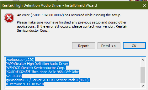

    This error resloved after a restart first but now it again occured and not resloving after many restarts
    Audio device is not listed in device manager.
    i have tried to re install drivers manualy but its showing error NO AUDIO OUTPUT DEVICE INSTALLED dc2ea943-0567-4892-9e4f-f5931b783f7e?upload=true.png
    "An errror -5001 : 0x80070002 has occured while running the setup.
    Please make sure you have finished any previous setup and close other applications.if error still occur please contact your vendor:Realtek semiconductor Corp..
    Details-
    >setup.cpp 1220
    PAPP:Realtek High Definition Audio Driver
    PVENDOR:Realtek Semiconductor Corp.
    PGUID:f132af7f-7bca-4ede-8a7c-958108fe7dbc
    $21.0.338
    @Windows 8.1 / Server 2012 R2 Service Pack 0 9600
    IE Version: 9.11.18362.0."
    Things i have tried
    • I tried to install drivers but is failed
    • Tried to sfc scan
    • Restarted audio services
    • Uninstalled updates
    Bluetooth earphones are working but 3.5mm jack is not working too.

  2. No Audio Output Device is Installed
    You will need to select Windows 8 from the drop down list while installing the driver in compatibility mode.
    I would suggest you to try setting the speaker as default audio output by following the steps below and check if it helps.
    1. Right click on the sound icon on the right bottom corner of the taskbar.
    2. Select "playback devices".
    3. If "speaker" is not set as the default device, highlight it and click "set as default".
    5. Save the changes.
    Let us know the result.

  3. fireberd Win User
    No audio output device is installed
    A screenshot of the Device Manager, Sounds section is still needed. Can't really offer a suggestion until I see what is showing there now.
    e.g this is mine It shows AMD which the audio for HDMI, Realtek and Tranzport which is a wireless controller for my recording studio program.
