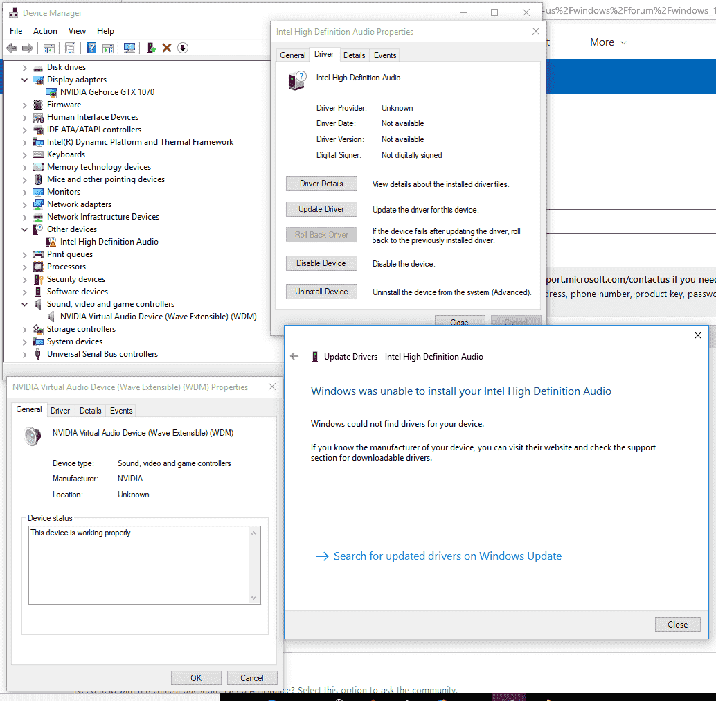

    I have no sound from my laptop after an update.
    Things I have tried:
    1. restart pc, didn't work
    2. update drivers, didn't work
    3. uninstall device, didn't work
    I have No audio output device is installed. Windows 10 laptop. 48a0168c-be0b-46d1-943b-eda91e9b0132?upload=true.png
    what appears to be two devices I have tried uninstalling both individually, to no avail.
    I think I need to manually download and install the drivers for the Intel High Definition Audio, but I'm not sure which I need. Are these the same as the Realtek drivers?
    MatrixPeckham, Oct 10, 2018
  2. No Audio Output Device is Installed
    You will need to select Windows 8 from the drop down list while installing the driver in compatibility mode.
    I would suggest you to try setting the speaker as default audio output by following the steps below and check if it helps.
    1. Right click on the sound icon on the right bottom corner of the taskbar.
    2. Select "playback devices".
    3. If "speaker" is not set as the default device, highlight it and click "set as default".
    5. Save the changes.
    Let us know the result.
    Wungraileng Vashi, Oct 10, 2018
