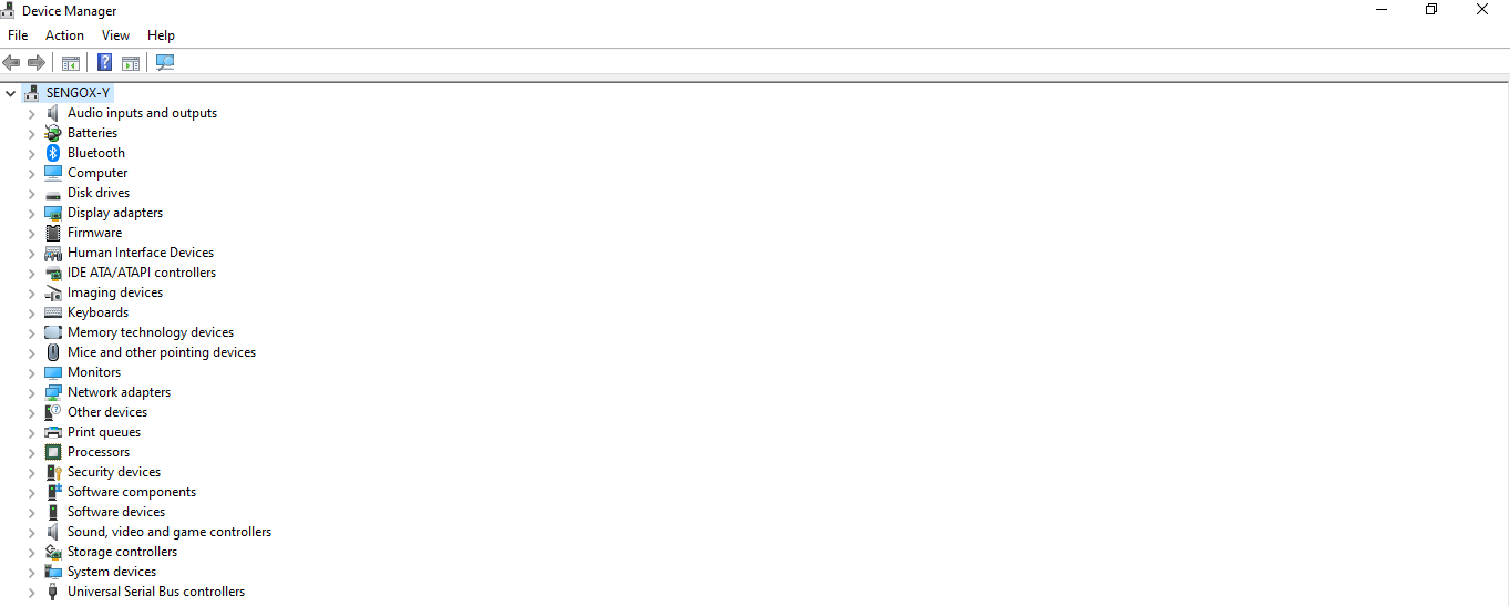

    No Biometric Devices in Device manager.
    hello,
    My hp pro book computer doesn't have biometric devices in device manager.Even when I select show hidden devices it does not appear.What should I do?
    No Biometric Devices in Device manager. 5b89743a-bcf5-49a0-abe5-627849259e17?upload=true.png
    Yo Sengox, Aug 29, 2020

  3. biometric devices
    I have follow your 3 steps ,but still can't find Biometric Devices
    in device manage and control panel.
    How can i know is there something wrong with the hardware?
    Robert_107, Aug 29, 2020
