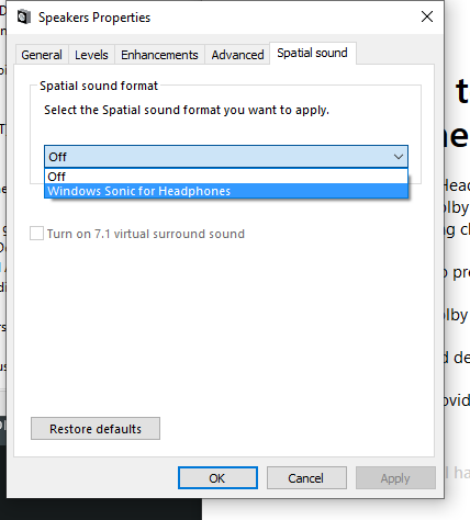

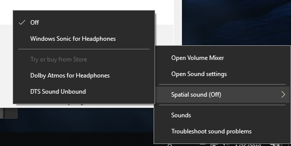

    I had Dolby Atmos for Headphones working on an old PC. I decided to upgrade and when I did I realized I was no longer able to select Dolby Atmos for Headphones in my spacial sound settings. I installed the app and when I did, the Spacial Sound setting changed from "Dolby Access" to "Dolby Atmos for Headphones"
    No option to enable Dolby Atmos for Headphones? 2560ac67-feb0-46a8-8bf7-59f7d148b6f9?upload=true.png
    However, when I go into preferences for my device and look at the spacial sound settings, I am greeted with this...
    No option to enable Dolby Atmos for Headphones? 5559fd0f-6944-40e8-a285-ad341f02ba03?upload=true.png
    No option to enable Dolby Atmos for Headphones.

  2. cozkaptan Win User
    Can't enable Dolby Atmos for headphones in spacial sound
    I fixed the issue today for my PC but I am not sure if it is me or them.
    • I uninstalled any Dolby app installed on my PC by using IObit Uninstaller.
    • It asks you to do Powerful Scan which basically scans the Registry Editor to clean any residue after an uninstall.
    • Delete everything it finds and then restart your PC.
    • Enable Dolby Atmos for Headphones from Spatial Sound settings and reinstall Dolby Atmos when prompted.
    It should be working now. Hope this fixes...
