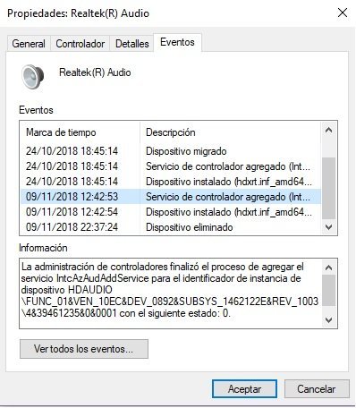

    Today, while watching a movie on Netflix on my laptop (MSI GV62 8RD-200, Intel core i5, Windows 10), my laptop suddenly froze and wouldn't budge no matter what I did, so I had to hard reset it. After turning it back on, I came to see that my audio display on the bar had a red cross over it, and it displayed the message, "No output device installed".
    It came to me as something weird, since it clearly worked 5 minutes before, and no matter what I do, it does not solve. I tried to uninstall and reinstall my audio drivers (Realtek Audio), but it always show up as if it were disconected. I try to enter to Settings from windows, and the Settings window wont load at all.
    The closest I can find from the Realtek Audio properties, is this (Which I can only see by looking for the hidden devices in the device manager, that comes close to the time when it started having problems).
    , No output device installed. 95d3495a-ff0b-46fa-b925-a4da6e439261?upload=true.jpg
    Also, if I try to manually install it from the device manager, I end up with a blue screen rebooting my laptop, and doing absolutely nothing to solve my problem.
