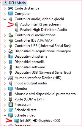

    I installed the newer drivers, and in Device Manager I can see the Intel Display Audio device.

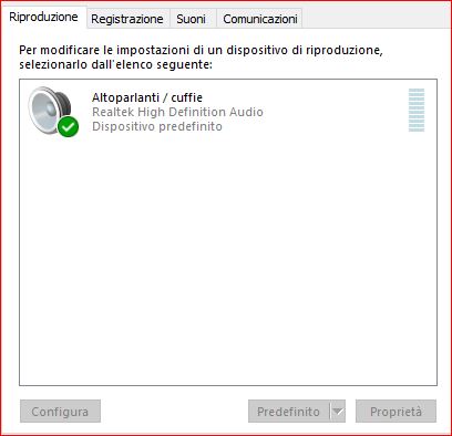

    I can send the video output to the Smart TV, but no audio. In fact, the Intel Display Audio device isn't listed in the Sound Manager, so I can't set it as default audio device.

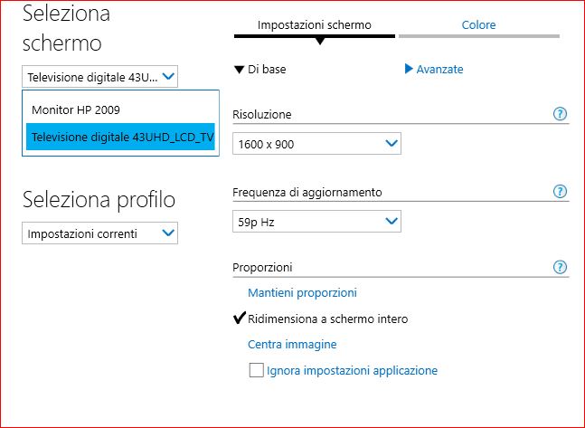

    The Intel Graphic Card Control Panel recognize the Smart Tv.
