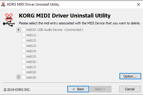

    The KORG Midi Driver Uninstall Utility correctly lists the midi device, shows it's installed and in this case it's in slot 10:
    No USB midi input until Ryzen chipset driver installed db001607-f2ae-4538-9b02-09fadca333c2?upload=true.png
    So, everything's supposedly looking fine. But Ableton Live doesn't see any devices. Same with Midi-OX - it reported that there are no input devices on start-up.
    Turns out I needed to install the Ryzen chipset driver for it to work. I downloaded my version from my motherboard manufacturers site, but you can also get it directly from AMD.

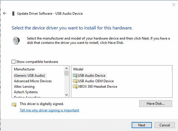

  4. Piotrbre Win User
    USB MIDI driver's can't be installed [WIN10]
    Thank you for responding,
    Well it does seem to be "installed", except i have no idea how i can get the "installed" driver onto my midi-device, when checking the list of installed driver's i don't seem to find my "roland midi driver" (btw i checked the Yamaha midi driver, it did not
    work).
    Still selecting the .inf file from the location where it's installed right now gives the exact same error i started with.
    No USB midi input until Ryzen chipset driver installed 765471a3-789f-4a3c-a12c-d69927fbc6f4.gif
    Piotrbre, Jul 13, 2019
