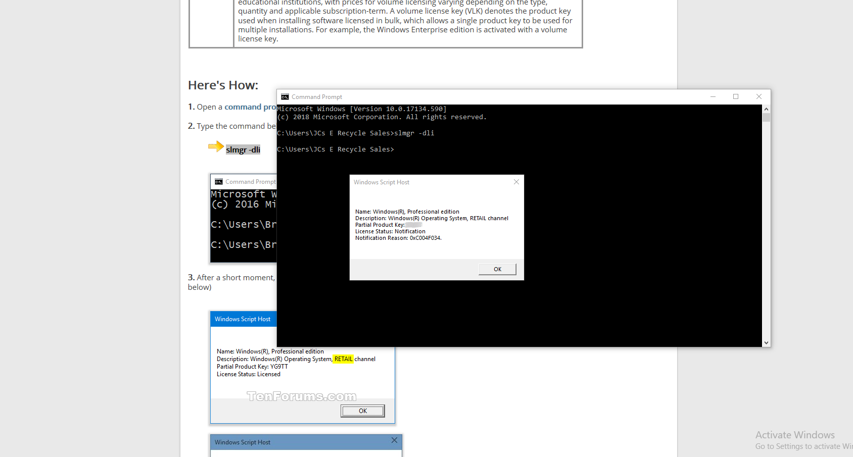

    Hi, I recently upgraded my system's motherboard, cpu, gpu, ram and psu, anyways I don't have windows anymore.
    I checked my settings and can confirm that I had a retail windows 10 pro version, I tried the re-activation process, but it doesn't work, I'm a student and need my pc for work, pls help.

    Usually the error code 0xC004F213 comes when there is a hardware change done on the computer (like Motherboard or Hard drive). The Windows license is associated with the device hardware. If there is any significant hardware changes, such as replacing
    motherboard or hard drive, Windows won’t be able to recognize the license.
    I suggest you to try the troubleshooting steps from the article
    Reactivating Windows 10 after a hardware change
    and see if Windows gets activated.
