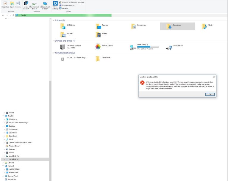

Discus and support Not able to remove Local Disk L: in Windows 10 Network and Sharing to solve the problem; [ATTACH] Hi As you can see I have a L: disk that is connected to nothing I need to remove it, and have no idea how I can do this... Thanks... Discussion in 'Windows 10 Network and Sharing' started by Harrie Barron, Jun 12, 2019.
  1. Not able to remove Local Disk L:
    Not able to remove Local Disk L: 46fcad1a-5ac2-4d92-83ab-426c5d9ea09d?upload=true.jpg
    Hi
    Thanks

  3. topgundcp Win User
    local disk f
    This looks like the F: drive is the EFI partition having a size of 300MB. Open Admin Command (Win+X->Command Prompt (Admin)) and type:
    diskpart
    select disk 0
    list partition =====> take a note of the partition # having 300MB. My guess is partition 2
    select partition # =====> replace # with the number in step above
    remove =====> remove the drive letter
    exit
    This should remove the drive letter and won't show up in "This PC"
    P.S
    do not delete this partition, you won't be able to boot.
    topgundcp, Jun 12, 2019
