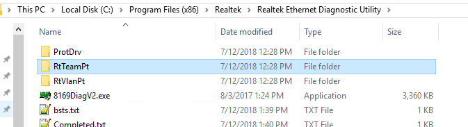

    Navigate to you Realtek Diagnostic program directory

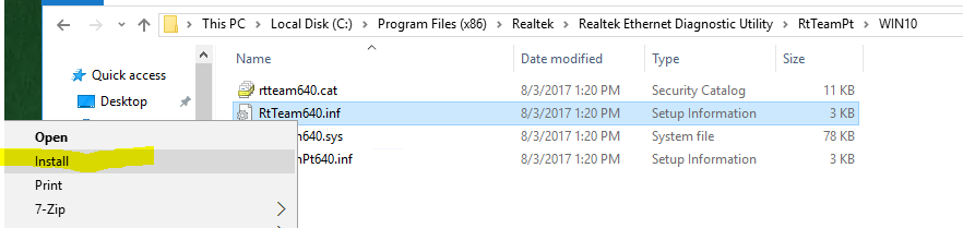

    Next open the Teaming directory > Win10
    Right-click on the RtTeam640.inf file and select INSTALL

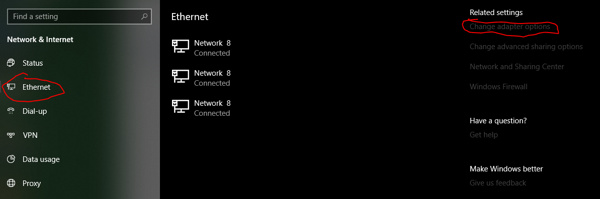

    Now if we go into our Network and Sharing center > Change Adapter Options
    (Note, if you are on Windows 10, build 1803+, you will need to go to Network and internet settings, click on Ethernet, then you can go into 'Change Adapter Aptions')

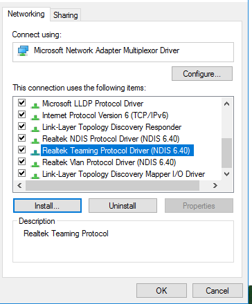

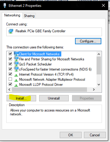

    From here, right click on your adapter and select Properties

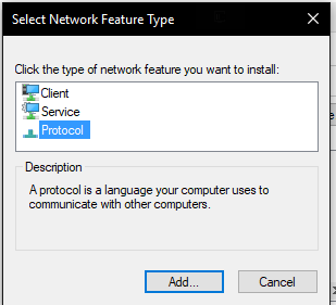

    Click Install

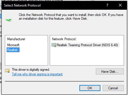

    Select Protocol
    There should be Realtek under Manufacturer, with a teaming options.
    Once this is installed, you will see the teaming option under in the properties menu.
    Note: This is where Windows Server 2016 and Windows 10 diverge. I was able to setup teaming in the Windows Server Manager, instead of using the diagnostic utility. However, (and I will be testing this as soon as possible) in the Realtek Diagnostic Utility, it should now show the Teaming options.
