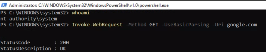

    This was a sudden and totally unexplained change, this had always worked before. To test I used PSExec to open a PowerShell console as the SYSTEM user. I then attempted a PING, NSLOOKUP followed by an Invoke-WebRequest, which failed. I then performed the same test on 3 of the healthy machines at random, and all SYSTEM users were able to GET a website using Invoke-WebRequest. To rule out an issue with PowerShell, I also tried creating a C# console application in the .NET framework that tried a HTTP POST and GET using System.Net.WebClient - this worked on the healthy machines and failed on the problematic desktop, just the same as the PoSh test.
    In the following screenshot you can see I am running a PowerShell console on a healthy machine as NT AUTHORITY\SYSTEM, and that I get a successful response to Invoke-WebRequest:

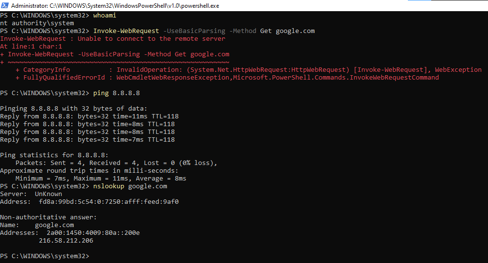

    The exact same test fails on the problematic device, in this screenshot you can see I am running the console as SYSTEM, PING works, NSLOOKUP works but the Invoke-WebRequest fails:
    NT AUTHORITY\SYSTEM can no longer make HTTP requests, sudden change 4bce7e19-7a91-47f9-af6e-3f0a54a4aff3?upload=true.png
    The reason I have come here for help is that the issue has now started on a 2nd device, randomly, 2 months after the first device had issues. I have spent about 20 hours trying to diagnose and resolve with no luck.
    If I run the services as a different user I can get them to work as expected, but I really need to identify the root cause of this crazy behaviour.
    - This happens when the devices are on different networks, even 4G hotspots with zero security controls
    - It happens when the Windows Defender Firewall is disabled
    - There are no proxies
    - I tried -UseBasicParsing but the Invoke-WebRequest switches do not matter, as System.Net.Webclient also failed
