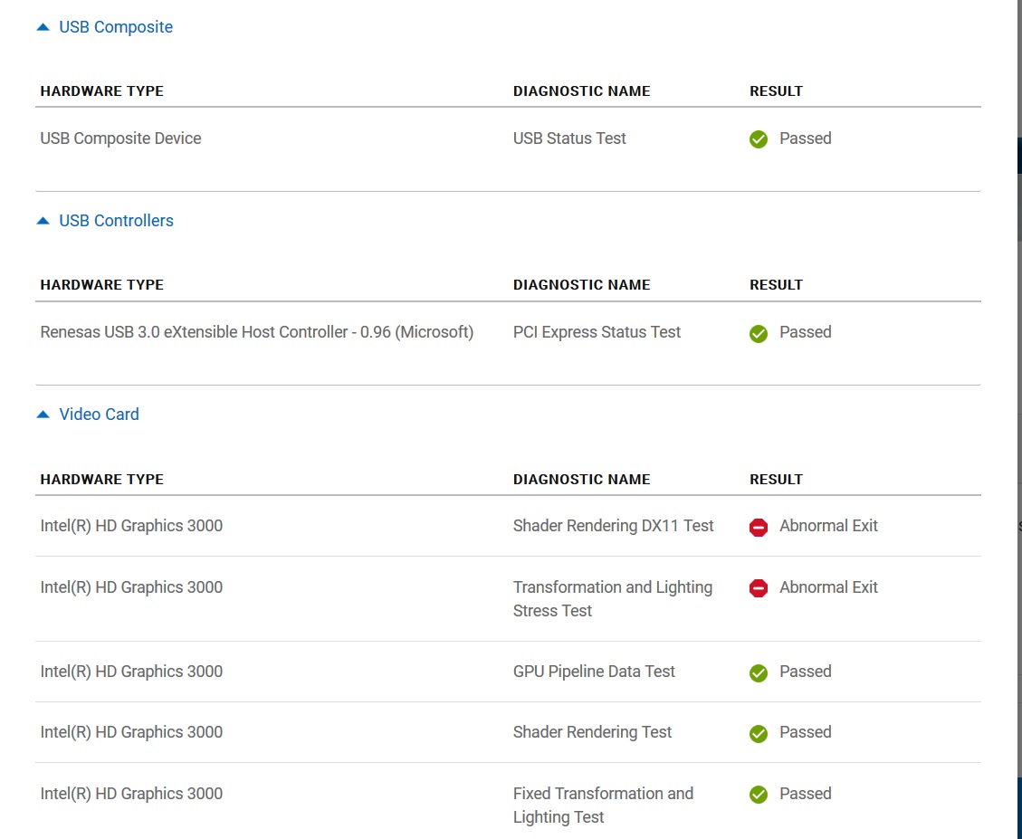

    My PC started running problems a few days earlier. It started crashing displaying BSODs, every time with a different error. So, I decided to do a complete clean reinstall of Windows 10. I did that yesterday but of no help. My computer is still crashing with ntoskrnl.exe being the reason. It crashes every 2 3 hours with a BSOD.
    I have updated using Windows updates. I tried the method presented in this link: https://answers.microsoft.com/en-us/windows/forum/windows_10-update/driver-verifier-tracking-down-a-mis-behaving/f5cb4faf-556b-4b6d-95b3-c48669e4c983 but after doing the setting and restarting, I couldn't boot into Windows and had to reset the verifier using safe mode. I ran all the hardware tests using Dell support diagnosis system and could find only couple of errors as shown in the image attached.
    ntoskrnl.exe causing crash and BSODs on Windows 10. Please help 271efd57-bfba-4e11-9795-161318d5f793?upload=true.jpg
    Please help me as I am not able to decipher the problem here.
