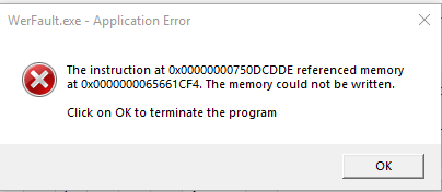

    Whenever I try to log in to my OneDrive. I get this error. I cannot uninstall OneDrive completely from my PC. Please help me on this. Thanks in advance. One Drive error 0b45fc0a-6311-4968-8705-1a202a3f8dfc?upload=true.png

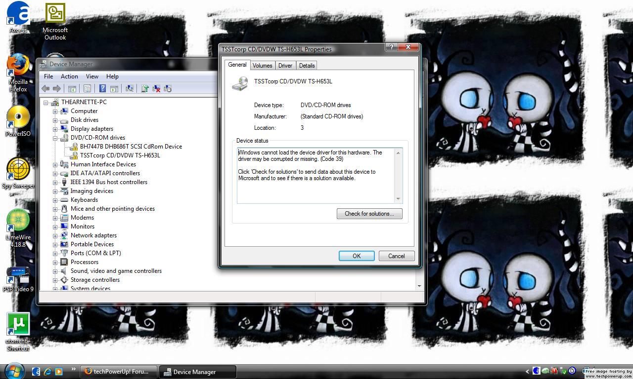

    1) Close all open programs
    2) Click on Start, Run, and type REGEDIT and press Enter
    3) Click on the plus signs (+) next to the following folders
    HKEY_LOCAL_MACHINE
    SYSTEM
    CurrentControlSet
    Control
    Class
    {4D36E965-E325-11CE-BFC1-08002BE10318}
    4) This folder is the DVD/CD-ROM Drive Class Description in the registry. Look for any of the following names in the right hand column.
    UpperFilters
    LowerFilters
    UpperFilters.bak
    LowerFilters.bak
    5) If any of the above keys shown in step 4 are listed, right-click on them and choose Delete
    6) After deleting the keys, close the Registry Editor
    7) Reboot your computer
    8) Open My Computer and check to see if your CD or DVD drives have returned. You may also want to open Device Manager and verify that the yellow exclamation and error code on the CD or DVD drive is gone.
    And it likely has something to do with the emulated drive you have listed there.

    I was trying to install dead space on my computer, and the CD drive is not listed under my computer. Upon looking in device manager I can see that the drive has an error, and windows says it's driver related. I have no idea what to do from here, any help would be greatly appreciated. Thank you.*Toast :toast:
