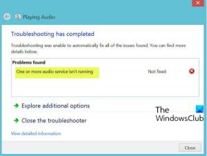

Discus and support One or more audio service isn’t running error in Windows 10 News to solve the problem; [ATTACH]Are you encountering the Audio service error message One or more audio service isn’t running? If so, read on! In this post, we will outline […]... Discussion in 'Windows 10 News' started by WinClub, Sep 4, 2020.

    As you receive the error message: 'one or more audio service isn't running', this might have occurred due to the audio services.
    I suggest you to restart the service, set it to automatic and check if it helps.
    Step 1: Stop the Windows Audio service.
    • Press Windows Key + R on the keyboard and type
      services.msc
      , Services window gets opened.
    • Search for Windows Audio service, right click on it and click on
      Stop.
    • Restart the computer.
    Step 2: Start the service and set it to automatic:
      services.msc
      Properties.
    • Start the service, set
      Startup type to Automatic.
    Hope it helps. Reply to the post with an updated status of this issue for further assistance.

    The Audio services not responding problem is very likely due to an outdated, corrupted or incompatible audio driver on your Windows. I'd like to ask, what do you mean by "to
    boot in safe mode and or clean boot / wipe the system and that wouldn't be possible in my current situation"? Are you connected via domain server? Are you getting any error messages when you try to boot into safe mode and perform a clean boot?
    In the meantime, I suggest that you follow these steps:
    Step # 1: Restart your audio services.
    1. Press Windows key + R and then type services.msc and click OK.
    2. Find and right-click on "Windows Audio", then click Restart.
    3. Right-click on Windows Audio one more time, this time click Properties.
    4. Set the Startup type to Automatic. Click Apply > OK.
    5. Do the same thing to "Windows Audio Endpoint Builder".
    Note: If the Restart option grayed out, your Windows Audio Endpoint Builder service is not running, click Start instead.
    Step # 2: Uninstall the audio driver in the Device Manager. Open Device Manager> Sound, video and game controllers> Right click the driver> Properties> Driver tab> Uninstall Device> Restart
    your PC, and Windows will attempt to reinstall the driver.
    Note: If the same issue persists after reinstalling the driver, please contact the audio card manufacturer's website and find and download the correct drivers for your device. Then install it on your computer manually.
    You may also refer to Fix sound problems article
    for more information.
