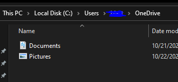

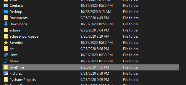

    I uninstalled Onedrive from my computer as per usual as I don't like it running in the background and also just having its own folders. This time though the documents folder of the computer and pictures folder of the computer are both by default a directory in Onedrive for some reason. There is a documents folder that exists but it doesn't have the documents icon and isn't what the side button in file explorer leads too. So basically what I want to know is how can I remove these folders and replace them with the actual documents in my user sub directory, or change/ replace.

  4. Onedrive documents
    Document Library hijacked by OneDrive after update
    This issue may be due to an incorrect location target. To correct this, kindly follow these steps:
    • Right click the Documents folder where OneDrive files are showing.
    • Select Properties, and then Location. Yours might look like this:
      C:\Users\Your username\OneDrive\Documents.
    • If this is the case, you will need to create a new folder, select all the OneDrive files in the
      Documents folder, and then change its location to transfer it to the created folder.
    • After emptying the Documents folder, right click it and change the location to:
      C:\Users\Your username\Documents.
    Feel free to post back should you need any help with Windows.
