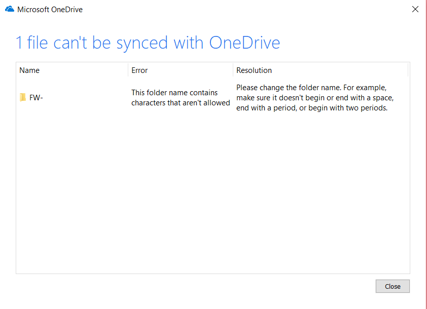

    My OneDrive tray icon tells me there is an error syncing a file on my computer:
    I have tried deleting the folder and renaming it and this is what happens:
    OneDrive Sync Issue [​IMG]
    I have tried signing out and back in again as well. The flickering icon in the tray is very annoying. can someone please help me find a solution?
    Garland Wilder, Feb 19, 2019

    Honestly, I don't understand why you haven't already tried to boot with WinPE or other live disk and manually remove the file? This example using Macrium WinPE boot disk, download Macrium Free and let it create a boot disk for you. Option to create one is shown automatically when you launch Macrium first time:
    1. Switch to C: drive
    2. Change the working folder to your OneDrive folder
    3. Check that the file has no Read Only (r) and System (s) attributes set. As the file name in your case is quite long, you don't have to type the full name. Use the *.* wildcard to replace any number of characters in file name and any extension, in your case command attrib .849C*.* should be enough
    4. If r and / or s attributes are shown for the file, remove them with command attrib .849C*.* -r -s
    5. Check that attributes r & s are removed
    6. Delete the file with del .849C*.*
    (Steps 3 & 5 not necessary; step 3 because removing attributes as in step 4 removes them if set but does no harm if not set, and step 5 because the attrib command works for 100% sure if no error messages are given.)
    The file should be removed now. You can test with command dir .849C*.*, it should not be shown anymore.
