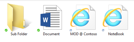

  4. borgus Win User
    Onedrive Sync Overlays missing
    OneDrive Explorer green checkmarks missing
    The green check mark overlay icons for OneDrive Explorer folders are missing. Below, how they should look...
    OneDrive has been uninstalled and reinstalled. The PC has been rebooted. Sync is working fine.
    There are no folders for OneDrive (or any other app) listed under this registry key...
    Computer\HKEY_LOCAL_MACHINE\SOFTWARE\Microsoft\Windows\CurrentVersion\Explorer\ShellIconOverlayIdent ifiers
    (On another PC there are seven OneDrive folders shown under that key, and two additional folders.)
    How can the overlay check marks be restored?
