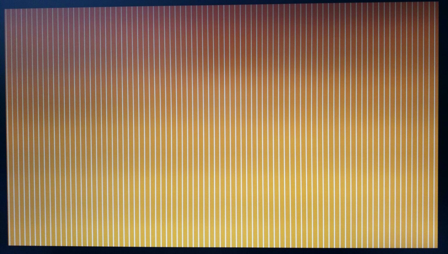

  3. SimplyInk Win User
    Windows 10 Shows Orange Screen with White Vertical Lines on boot
    Orange Screen (See picture below) appears on boot after Dell loading screen.
    • Dell Inspiron 580 w dual monitors
    • Dell Bios is latest version (A07)
    • Nvidia GeForce 310 (Driver version 341.95 - latest)
    • BitLocker enabled with no TPM
    • Hyper-V enabled
    Surprisingly, I can key in my BitLocker password at this orange screen and startup Windows... (Orange Screen On First Boot o_O)\
    If I suspend BitLocker this screen does not appear; but after I enabled it, the orange screen comes back again.

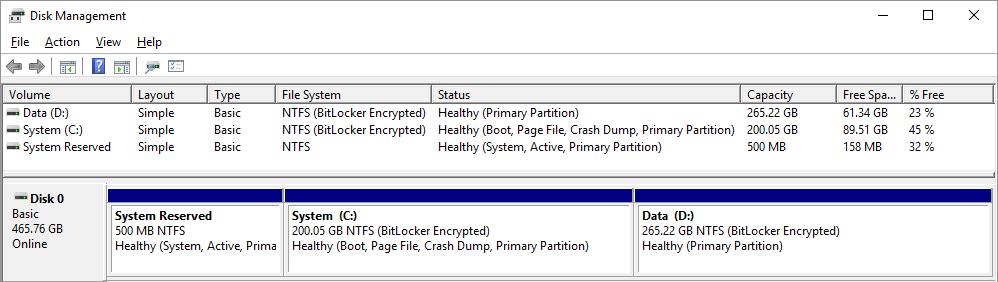

    Screenshot of Disk Management
    SimplyInk, Aug 3, 2020
