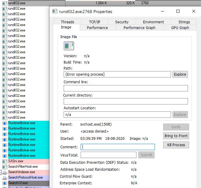

    There are so many RunDLL32.exe and svchost.exe in task manager, which slows down the system and even startup and restarts take much time. Help me out.
    Below is the screen shot from Process Explorer.
    OVER 20 RunDll32.exe and svchost.exe in TASK MANAGER ! 1a05373c-fb05-4670-8ad3-88f1c1e24f28?upload=true.jpg

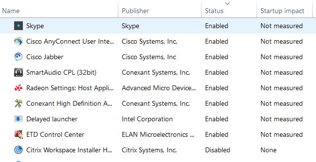

    Here is the screen shot of startup of task manager sorted using status.
    OVER 20 RunDll32.exe and svchost.exe in TASK MANAGER ! 1a17cf67-eb31-446f-b7f5-aef24fce86c0?upload=true.jpg

    Have you got lots of Rundll32.exe or svchost.exe processes running, or both?
    On a normal Windows 10 system, you should not have any Rundll32.exe processes running at all. Check your startup apps the see what is causing this:
    • Press Ctrl + Shift + Esc together to open Task Manager, click on the Startup Tab and see if there are any entries that are starting under rundll32, if there are, disable them
    • Press WIndows + R keys together to open the run dialog, type msconfig and hit enter. Click on the services tab and check the box marked 'Hide all Microsoft Services'. Then scroll through the list of services looking for rundll32 entries, if you find any,
      uncheck them and reboot
    With regards to svchost, i have noticed a huge increase in the number of these processes since the Creators Upgrade - I have 77 currently running on my system. They all are using 0% processor and HDD and on average about 1MB - 2MB, though this number does
    seem excessive . . .

    I found this in command line:
    "C:\WINDOWS\system32\rundll32.exe "C:\ProgramData\76L5453z1802c399\76L5453z1802c399.dll",LzcxHEfH"
    there is no service that have rundll32.exe entry
    I don't have any folder of this name i don't know what to do now
    i also tried debugging but no luck
