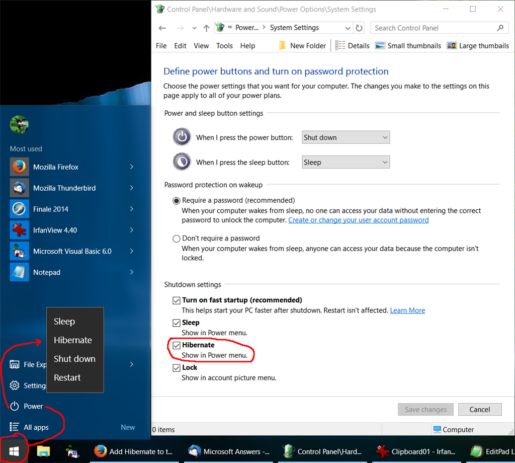

    Secondly, Windows 10 fully supports hibernating, and hibernation sometimes works even if sleep will not. Just in case, it may be worth following the steps below to enable hibernation:
    • Right-click the Start button and click Command Prompt (Admin).
    • Type the following command and press [Enter]: powercfg -h on
    • Close the command window.
    • Right-click the Start button and click Power Options.
    • Click Choose what the power buttons do.
    • Click Change settings that are currently unavailable.
    • Scroll down (if needed), tick Hibernate, and click [Save changes].
    • Click Start -> Power -> Hibernate to try out the new feature.
    If the hibernate option is missing in steps 7 and/or 8, your laptop probably has a driver issue preventing it from using low power states.
