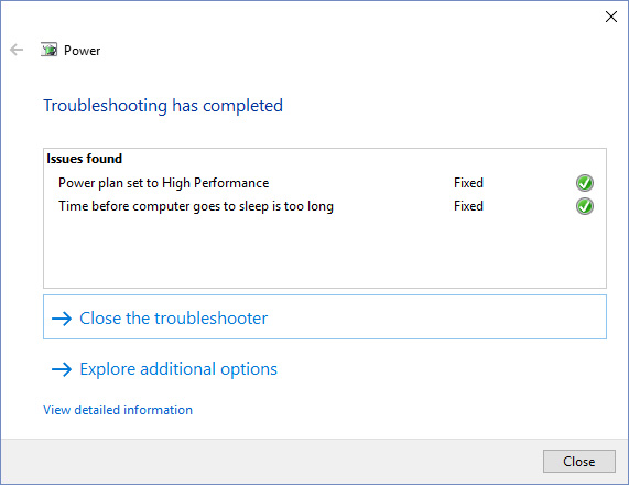

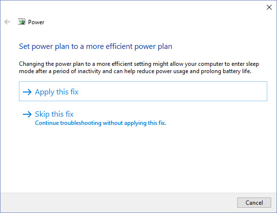

    PC goes to sleep after 2 minutes regardless of the power settings. It is not just turning the monitors off, it's actually going to Sleep. Today I was working on a resume and cover letter. I would write the cover letter and then read it back to myself to
    check the grammar and language, The PC would go into sleep mode during this process. It drives my nuts that I have to login to my PC every 2 minutes even though I'm actively using it.
    Troubleshooting:
    I ran the Control Panel "Troubleshoot problems" feature (Control Panel\All Control Panel Items\Troubleshooting\System and Security: Power). The troubleshooter runs and displays:
    PC sleeps after about 1 1/2 hours but changed settings are ignored f3bb167b-aac5-4a2b-95ed-d6c425132f11.jpg
    Then:
    PC sleeps after about 1 1/2 hours but changed settings are ignored 93be3632-9802-4c45-b5fc-3c917a6f1917.jpg
    What actually happened:
    • Power plan was changed from "High performance" to "Balanced (recommended)" *Troubleshooter message says the opposite.
      • On Battery:
        • Sleep after 30 minutes changed to 15 minutes.
      • Plugged in:
        • Sleep after 1 hour changed to 30 minutes.
    The troubleshooter stated "Time before computer goes to sleep is too long" so why do the dropdowns allow for up to 5 hours? Why, when I make any allowable change does the sleep settings default to 2 minutes regardless of the setting? Also, why does Microsoft
    offer multiple power plans and configuration options when they are just going to force you to "Use a more efficient plan"?

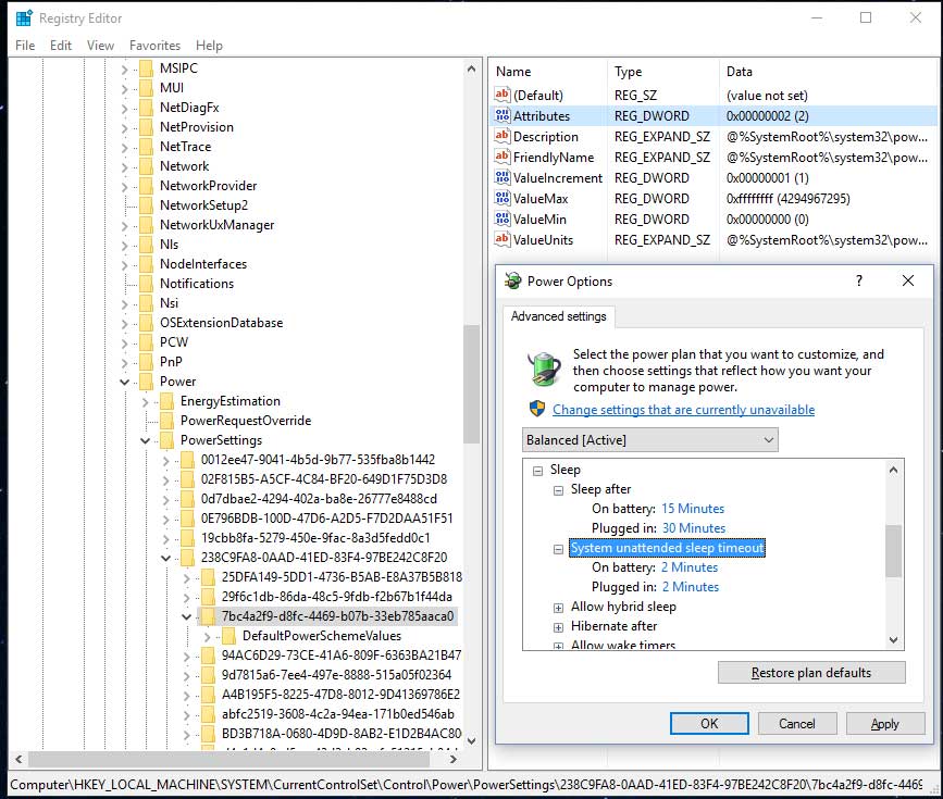

    So I found a possible solution:
    In REGEDIT go to:
    HKEY_LOCAL_MACHINE\SYSTEM\CurrentControlSet\Control\Power\PowerSettings\238C9FA8-0AAD-41ED-83F4-97BE242C8F20\7bc4a2f9-d8fc-4469-b07b-33eb785aaca0
    At the location there is a DWORD named "Attributes". Modify the value of "Attributes" from 1 to 2. A value of 2 will make "System unattended sleep timeout" appear in the advanced power settings under "sleep." Notice the default value is 2 minutes for both
    battery and plugged in.
    PC sleeps after about 1 1/2 hours but changed settings are ignored 33c9bcd6-8069-4c21-b47e-4f1503fb99bd.jpg
    Change the values to whatever you want them set to. I made mine match the "Sleep after" settings. Some people have reported that the settings will return to the defaults (2 minutes) occasionally. I have not experienced that yet but I will update this post
    if it does. I suspect they may have changed the power plan and forgot to change the defaults. Your changes will not carry across plans.
    Basically what is happening is your PC is being woke up in an unattended state so it defaults to the "System unattended sleep timeout" settings instead of the "Sleep after" settings. An unattended state is usually when the PC wakes of to do a task like Windows
    Updates or a wake on LAN (WoL) event. I'm not sure why the "System unattended sleep timeout" setting is used when I wake the PC with mouse movement, but the steps above seem to have solved my issue.
    rnardone, May 20, 2020
