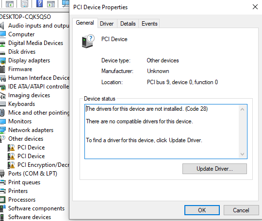

    PCI Device: The drivers for this device are not installed. Code 28
    I built a computer with my friend, and I think they may have skipped downloading some drivers. Displayed under my PCI devices is the error message in this photo. All three PCIs have an issue and when I attempt to search for their drivers nothing works. I believe I am meant to reinstall the drivers from the website of the manufacturer, but honestly, I don't even really know what a PCI is or how to know which driver to download. I have also had issues with my TP Link Wifi adapter disconnecting and reconnecting every hour and a half or so, and I expect that this is related since it is USB. Please excuse my ignorance!
    Should I try uninstalling all three from the device manager?
    PCI Device: The drivers for this device are not installed. Code 28 7c396a36-2683-4cdd-8f6a-2e503fc523f8?upload=true.png .
    BrookeB1, Jan 9, 2021

  3. jimbo45 Win User
    The drivers for this device are not installed. (Code 28)
    Hi there
    Go to the EVENTS panel and you should see something like this : (note this is just an example from my system - your's will be different of course).
    PCI Device: The drivers for this device are not installed. Code 28 [​IMG]
    Now with the Vendor info you should be able to google for the proper driver - or at least get the hardware vendor ID from which you can go to a website.
    Search on the characters between the \...and \ symbols or even just the first bit until you find a match.
    Cheers
    jimbo
    jimbo45, Jan 9, 2021
