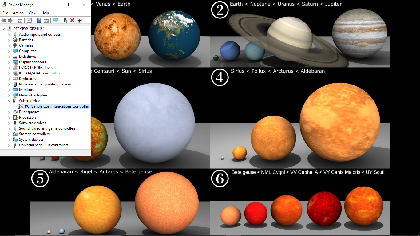

    I have just recently installed a clean up to date copy of Windows 10 using the creation tool. I booted my laptop from a flash drive and everything has gone well. The updates have all been installed and I have the Windows 10 20H2 platform all updated too.
    In my Device Manager though there is a yellow hazard board with an exclamation mark on it.
    PCI Simple Communications controller in Device Manager f11811ae-eee0-47b7-9bd1-610f283ec56d?upload=true.png
    I have right clicked on the Simple Communications and tried to update driver etc etc but to no avail. I believe it is to do my intel graphics. I downloaded the intel assistant and it gave me a in depth summary of my Asus K54C laptop but didn't have anything to offer. Can anybody tell me if this solvable, or nothing to worry about? Thank you. Jim

    Z87 or Z97 Motherboard? I had this and it was the intel management engine driver!
    PCI simple communication controller nowadays on an Intel system is code for the "Intel Management Engine"
