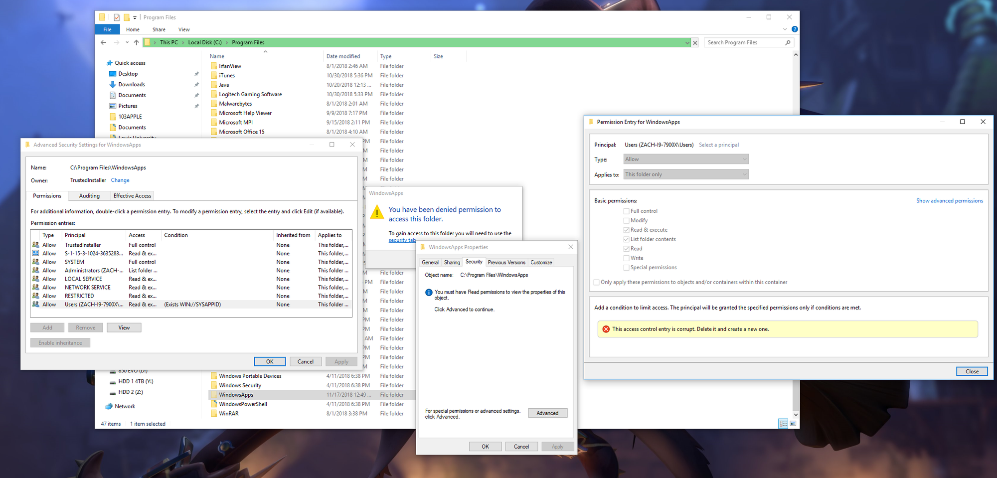

    I am trying to open the "WindowApps" folder, but am given a message that I don't have permission. I followed the prompts, but was given the error message in the screenshot I attached.
    How can I fix this issue?
    Thank you in advance!
    Operating System Information:
    Windows 10 Home 64-bit Build 1803
    Permission Access Issue 586af006-ed5e-42c8-9ceb-b08b9bb4b250?upload=true.png

    Taking ownership can sometimes just be the first step. You may then need to add your account to the list of those that have permissions and grant yourself full control. On the Security tab, to change permissions, click 'Edit', then click 'Add' to add your account.

    Presumably because TrustedInstaller is the owner (hence you need its permission), suggesting that img3.jpg was installed by Windows at some time.
    Presumably that also means it can be uninstalled. How did you get it in the first place? Where is it located?
    If you really want to delete it yourself, then taking ownership would seem a logical first step.
