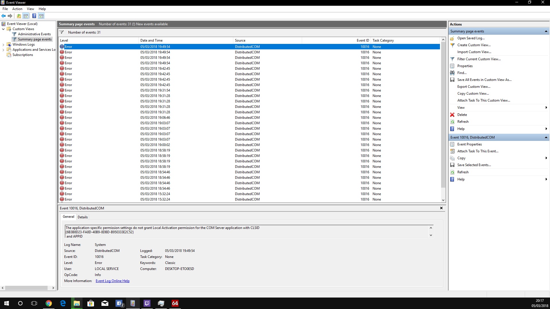

    about 30 times a day every day for the past 2 weeks. I've tried formating my pc, installing windows 10 form the ISO on ms site on different drives.
    Im at the moment running it on my samsung 960 pro evo nvme m.2, just to give you an idea how often it does it
    Persistent PC freeze and crash with Dcom 10016 being the problem 5314c595-d50f-465e-8d11-f696e5c55698?upload=true.jpg
    this is just from the past few hours. Ive reinstalled so many times, I'm confident its not my hardware as I build them for gaming and use decent parts.

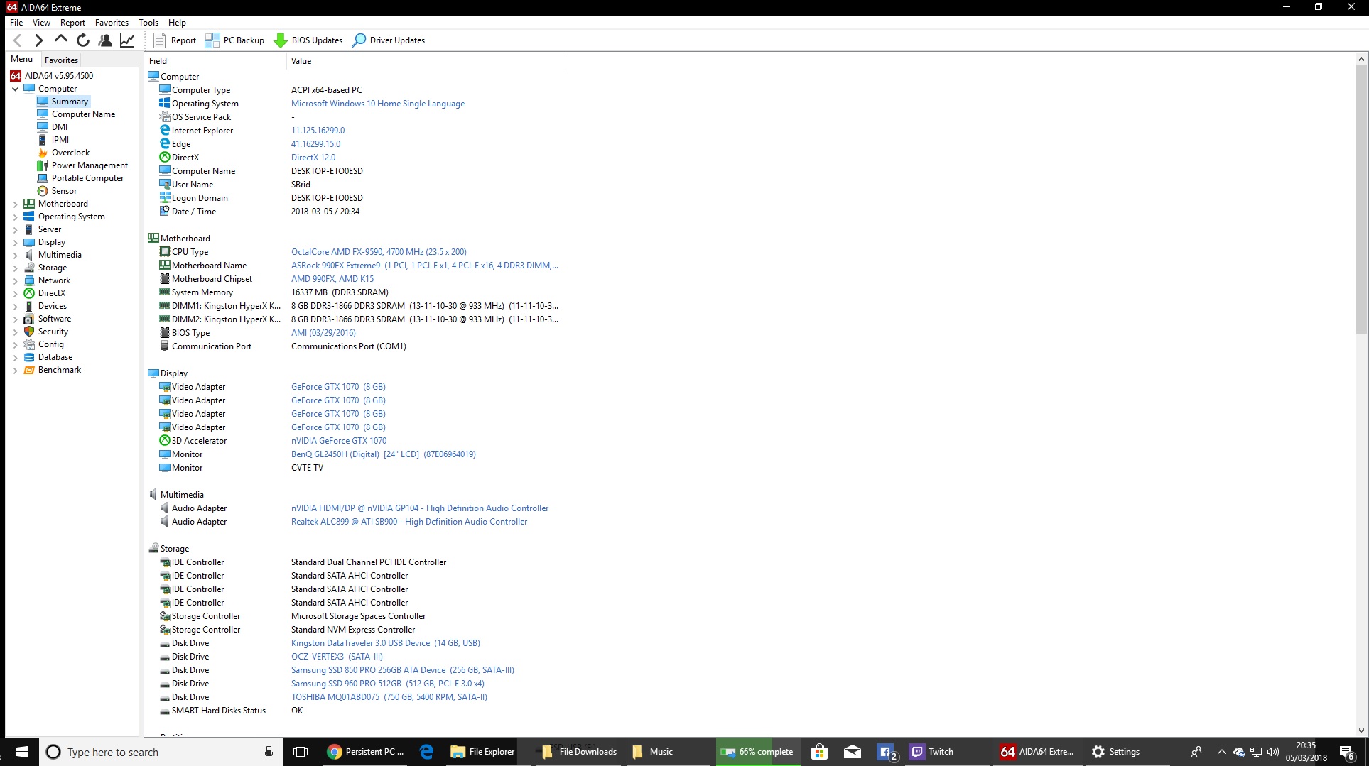

    heres a brief grab of my pc
    Persistent PC freeze and crash with Dcom 10016 being the problem d0844adc-0486-4636-b7bb-576c224cdeb8?upload=true.jpg
    I'm completely lost
