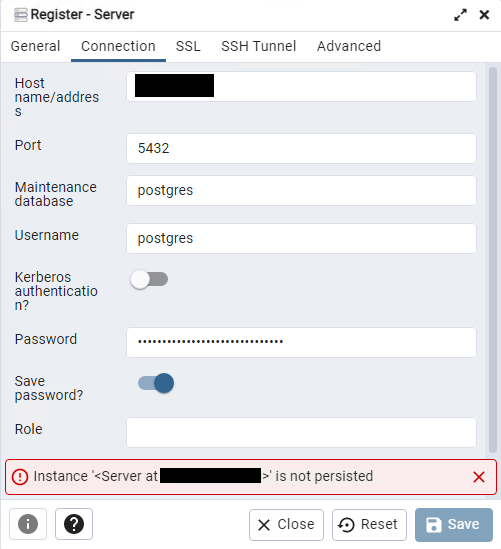

    PGAdmin, cannot register new server Instance Server at, is not persisted
    You might encounter the following error while registering a new server in PG Admin.
    Instance '<Server at <guid>>' is not persisted.
    PGAdmin, cannot register new server Instance Server at, is not persisted pgadminisnotpersisted.png
    The issue is mostly due to uninstalling and re-installing PG Admin or installing a different version of PG Admin.
    The resolution would be the following.
    • Close PGAdmin
    • Browse to C:\Users\<your user>\AppData\Roaming
    • Delete the folder PGAdmin
    • Open PGAdmin
    This will resolve the issue
