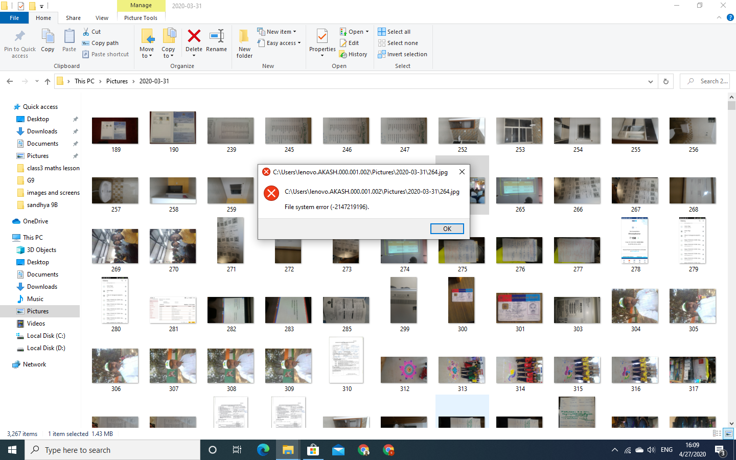

  1. Photo App File system error-2147219196
    whenever I open any picture, I am not able to open it in Photos App. File system error-2147219196. comes and the app goes off. I am not able yo open feedback hub also. I tried updating Photos App also, but no use. Photo App File system error-2147219196 d83f58dd-e079-4548-80be-1f5d06b7e6aa?upload=true.png
    akashdeep6, Apr 27, 2020

  4. Photo App File system error-2147219196
    Wouldnt open photos; file system error (-2147219196)
    Check out this link: https://www.winhelponline.com/blog/photos-store-apps-file-system-error-2147219196/
    You'll want to look at "Step 4: Uninstall Photos, Remove Leftover Files and Reinstall".
    (when you're at the psexec part, you might receive an error about access being denied to some of the files in the photos app folder (happened to me), just ignore them and continue untill the end of STEP
    4).
    When i first removed and reinstalled the photos app, it downloaded less than 100mb of data, and installed it.
    With the steps, described in the above link, it downloaded over 300mb of data!
    After install, the photos app is (for now) behaving as normal.
    I'll keep you informed, should the problem return!
    Eric_Cartman, Apr 27, 2020
