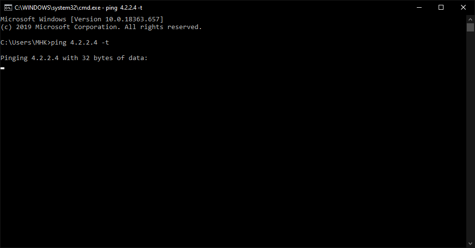

  1. Ping command doesn't work after new update
    Hello this is my system info:
    OS Name Microsoft Windows 10 Enterprise
    Version 10.0.18363 Build 18363
    After the new update my ping command doesn't do anything as shown below. I also can't find svchost.exe in the process tab which I think could be the reason behind this, Any idea how to bring back svchost.exe or fix the whole issue?
    Ping command doesn't work after new update 17b35dc7-d013-45ed-9227-4b583c77b393?upload=true.png
    Mohammad Hosein, Feb 28, 2020
