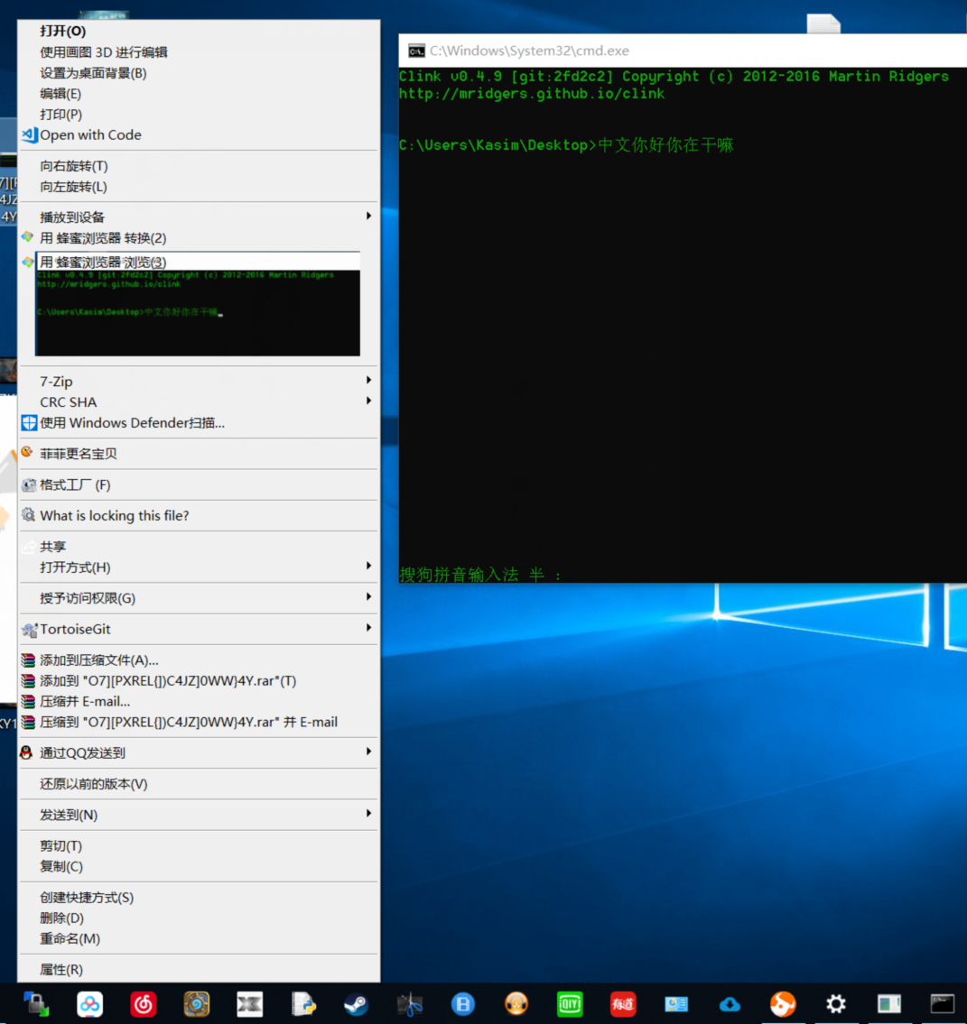

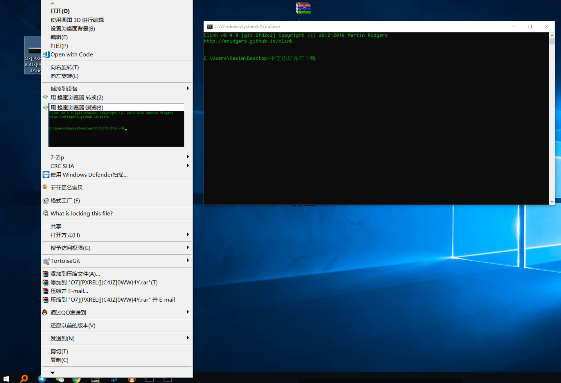

    Please fix the blur bug when dual monitors have different scale!
    The problem was mentioned several years ago https://answers.microsoft.com/en-us...-827e-42bf-86cf-1df8e530a9fb?tm=1507366207768 , and it's hard to believe that he hasn't been repaired yet !!
    I have exact sasme proble. I have two monitor :
    1. 1920x1020 scale 100%
    2. 2560x1440 scale 125%
    Because text are too small in monitor 2 , I had to set scale to 125% . The big problem is this setting also change the text rendering on monitor 1 , even if its scale is still 100%
    Monitor 1:
    Please fix the blur bug when dual monitors have  different scale! 356adfa2-53b0-4654-8e57-c984f0ad07b7?upload=true.png
    Monitor 2 :
    Please fix the blur bug when dual monitors have  different scale! bbdb7076-a8a2-4ba7-b463-c33b4b45957e?upload=true.png
    You should know mixing usage with different monitor would be more and more common as high resolution monitors are more and more !
    Please fix this .

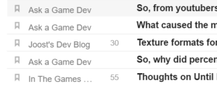

    A little experiment
    Lets look at an example of bullet point 2 using screenshots of Google Chrome rendering a webpage. The screenshots were made using the Windows screenshot functionality and cropped in paint.net.
    Image 1 - Correct DPI/scaling on HD screen
    The first image is an example of proper DPI on the 1920x1080 (HD) screen. The 3840x2060 (UHD) is also connected, but DPI scaling is disabled (set to 100%) for both screens. In this scenario everything displays as expected, but let me remind you that this
    is not a solution because at 100% DPI scale text on the 27" UHD screen is too small, as mentioned)
    Please fix the blur bug when dual monitors have  different scale! a7694436-a33e-49d9-a4e1-2cc0b43ba77a.png
    Image 2 - Incorrect DPI/scaling on HD screen
    This second image taken from the same HD screen is clearly more blurry than the first image. In this scenario the DPI scaling for the UHD monitor has been set to 150% (and the user account has been logged out and in as recommended by Windows when changing
    the setting). It appears that the scaling for the UHD monitor somehow affects the render on the HD screen, despite it having in fact the same settings as in the previous image. The blurring effect occurs in other applications like VS2015 and Windows Explorer
    as well.
    Please fix the blur bug when dual monitors have  different scale! 5fa116eb-3de2-48d0-87a0-f374c82279e3.png

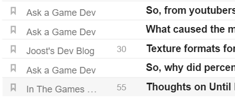

    Image 3 - Correct DPI/scaling on UHD screen
    The third and last screenshot is taken with the same settings as image 2, but from the UHD screen. As expected this image is larger because Windows requested from Google Chrome to render 150% pixels for the same area of the application to keep my eyes happy.
    This and the first image assert that Chrome is a DPI-aware application which can indeed render sharp images at different DPI scales.
    Please fix the blur bug when dual monitors have  different scale! de4ae3f6-3a75-4a66-87ea-b1ab70cc9f9a.png
    An interesting side note is that DPI-unaware applications do render at the prober 100% DPI scale without blurring when displayed on the HD screen with the settings used in image 2 and 3.
    I hope this clears up what my concerns are because I can't get much more detailed than this. Please fix the blur bug when dual monitors have  different scale! :)
