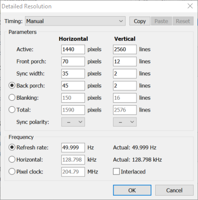

    I tried the CustomResolutionUtility and it automatically detects the proper resolution just fine:
    Portrait lcd panel resolution not detected by driver 220de22b-3815-4f53-8573-faf2176134f9?upload=true.png
    Unfortunately messing around with that tool didn't actually fix anything.

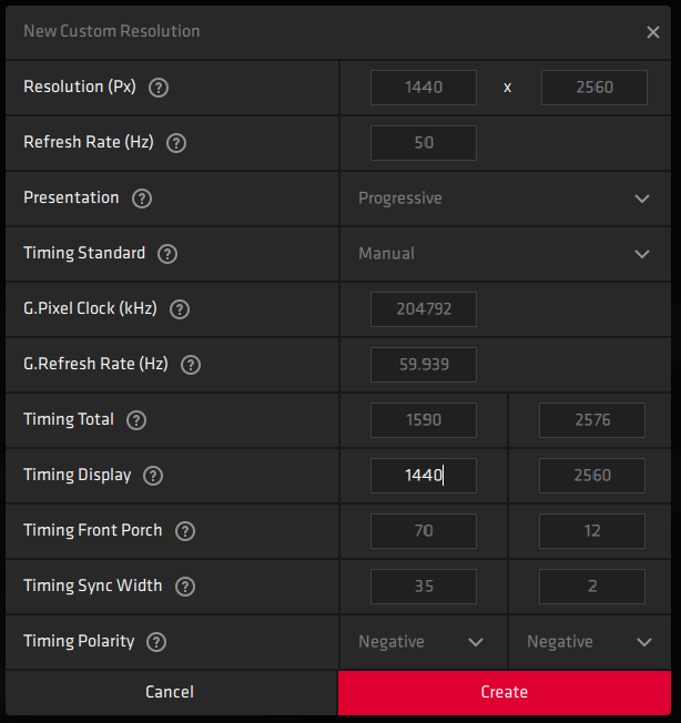

    So I tried setting that as a custom resolution in the radeon software settings by copying the parameters:
    Portrait lcd panel resolution not detected by driver 4a8d76ff-25c3-48b1-8dad-0b5183352221?upload=true.png
    leading into an error "Custom resolutions settings are not compatible with this display" and yes I picked the correct display.
    Note: Presentation let's me chose between Progressive and Interlaced so it corresponds to the interlaced toggle in CRU. Also tried Refresh rate of 49.999 with no difference

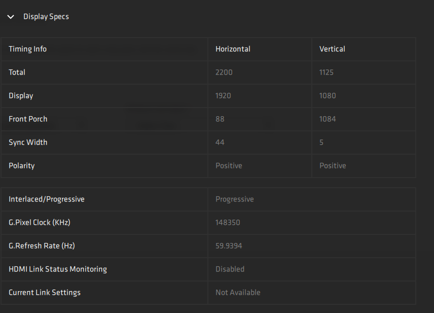

    This is what Radeon software thinks the display supports similarily to windows, which also lets me select 1920x1080 only:
    Portrait lcd panel resolution not detected by driver 8b1b44c2-60b9-4a67-afc0-9e996b6bd746?upload=true.png
    What's up with this disparity in specs and how can I fix it? Did I enter the custom settings wrong? Again, the LCD is fine albeit probably not properly supported. It works in Linux out of the box, without even a hitch. I might try live-booting linux on the laptop and try it on the laptop's hardware, will update when I do.
