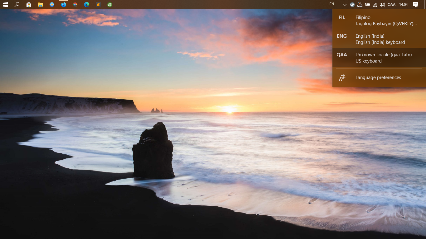

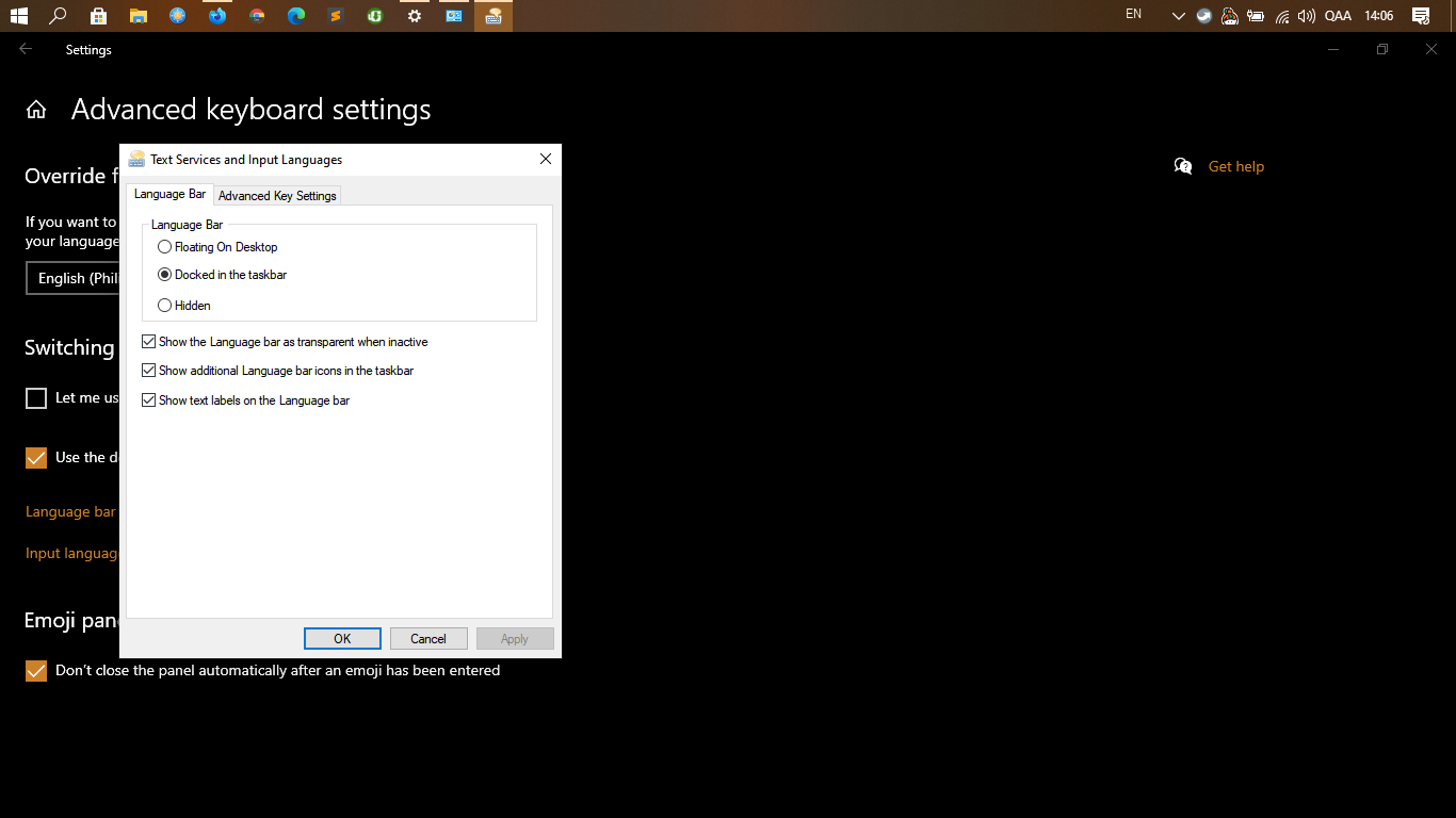

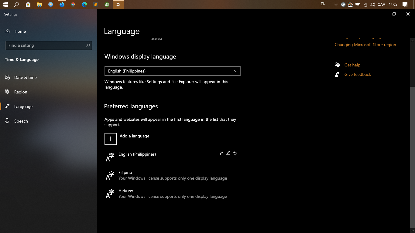

    Here are the Keyboard Layouts I want to remove:
    1. EN English India --> see Screenshot #1
    2. OL Other Language --> see Screenshot #1
    3. ENG English India --> see Screenshot #2
    4. QAA Unknown Locale qaa-Latn --> see Screenshot #2
    I took screenshots of all the settings and areas I can find related to Language and Keyboard Layout screenshots #3 and the rest.
    Screenshot #1

    Screenshot #2
    Possible BUG? -- How to remove Keyboard Layouts in the latest Windows 10 update? 14669ed0-1fe7-447e-a856-e2479b02d33e?upload=true.png

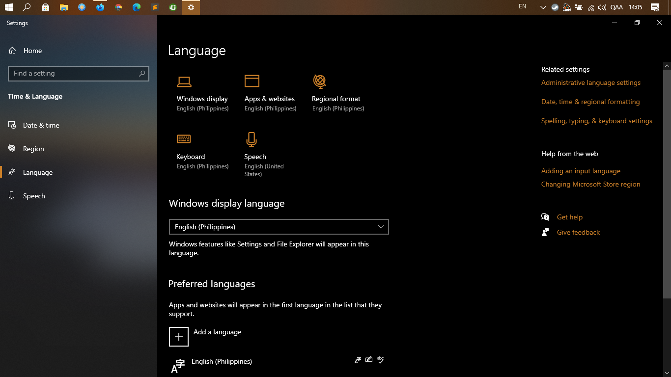

    Screenshot #3
    Possible BUG? -- How to remove Keyboard Layouts in the latest Windows 10 update? 1814b0ad-a6f2-4279-8b6d-2de8aa0a4fb4?upload=true.png

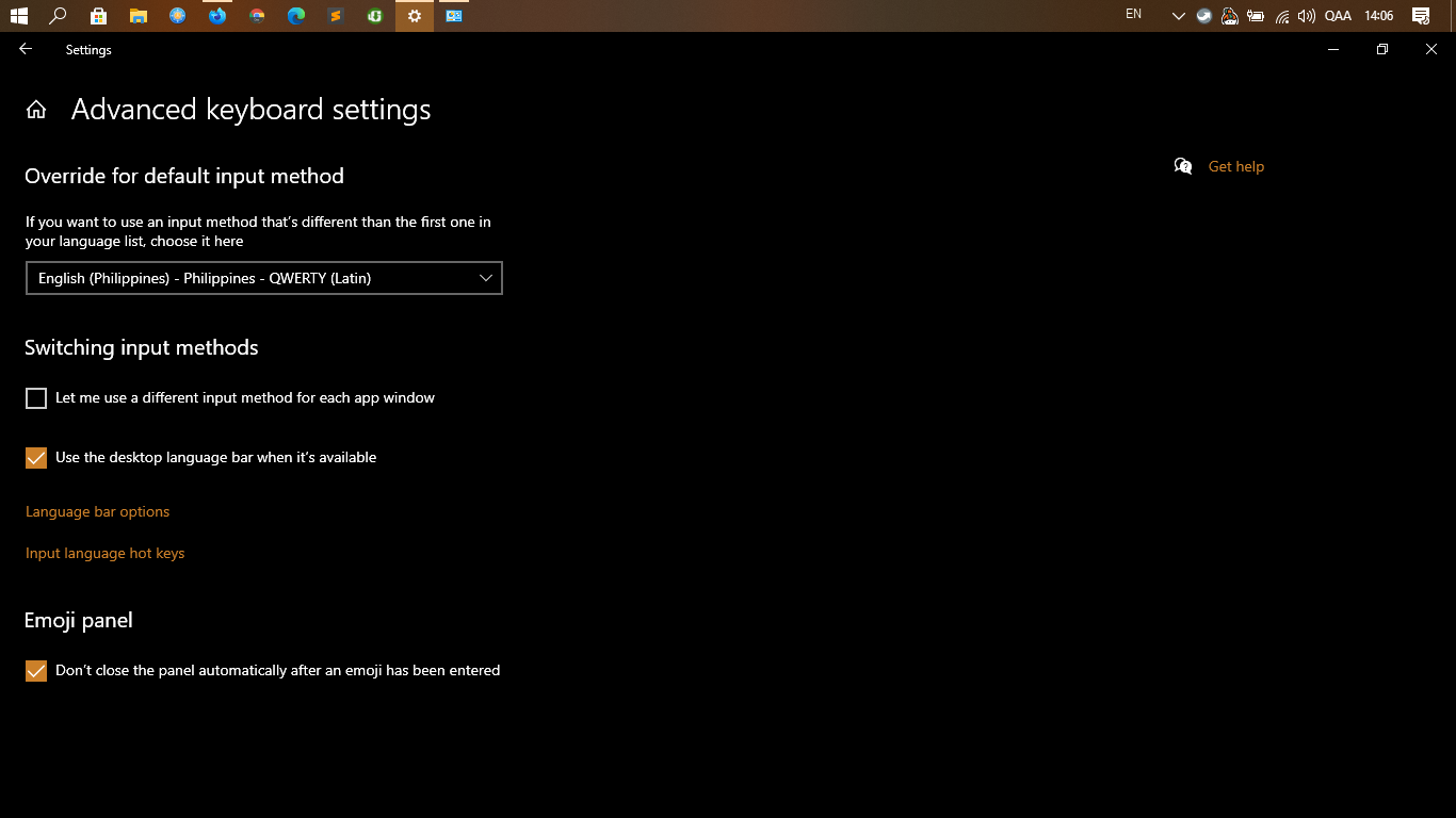

    Screenshot #4
    Possible BUG? -- How to remove Keyboard Layouts in the latest Windows 10 update? df1a75dd-c8db-4cf8-99af-c417a94bb64d?upload=true.png

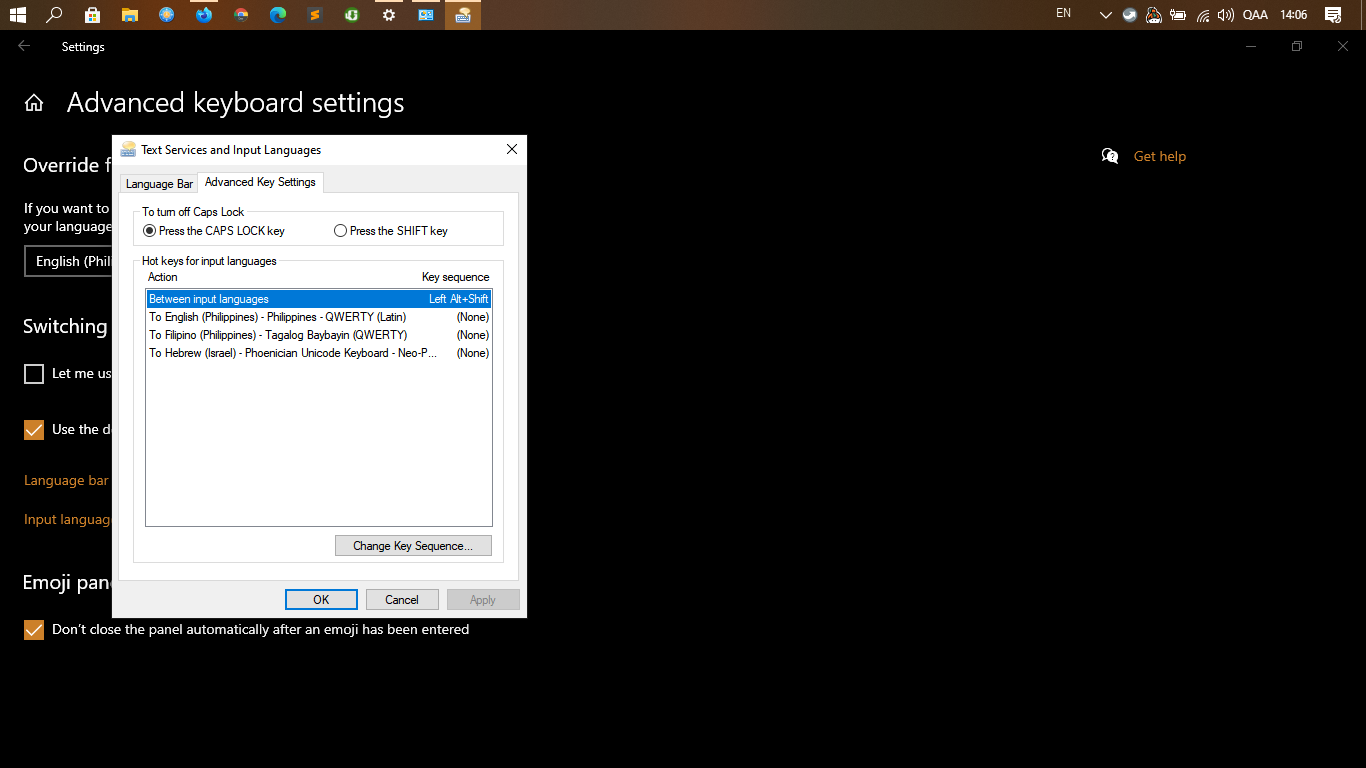

    Screenshot #5
    Possible BUG? -- How to remove Keyboard Layouts in the latest Windows 10 update? 1e21d665-9658-4240-9b10-e7ea3f776e6c?upload=true.png

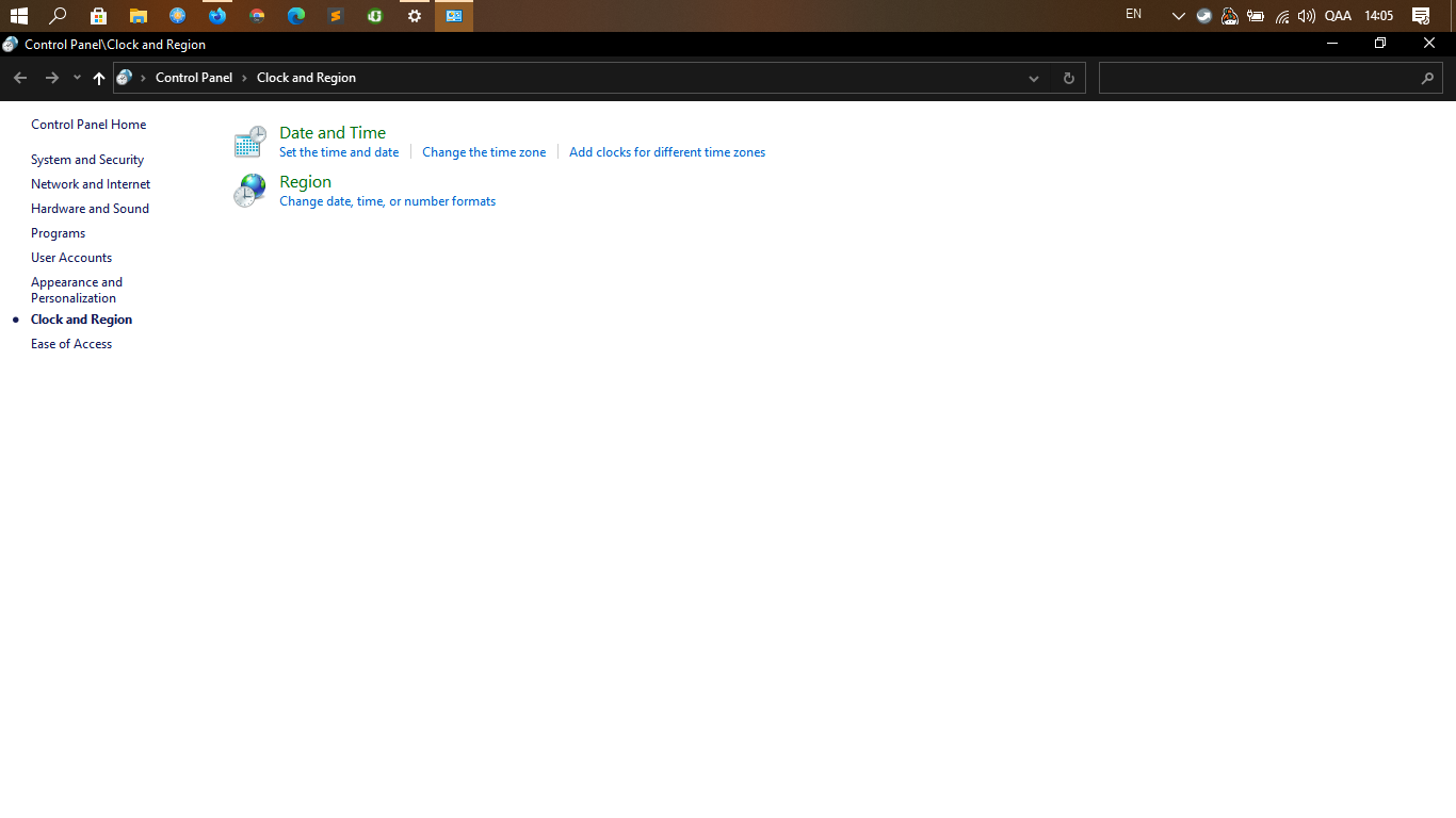

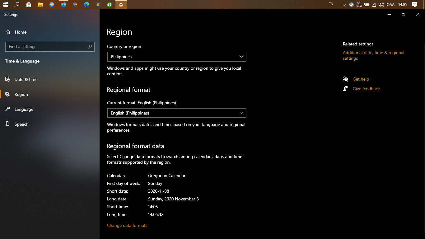

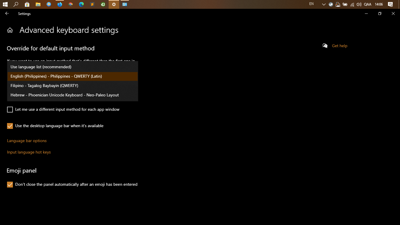

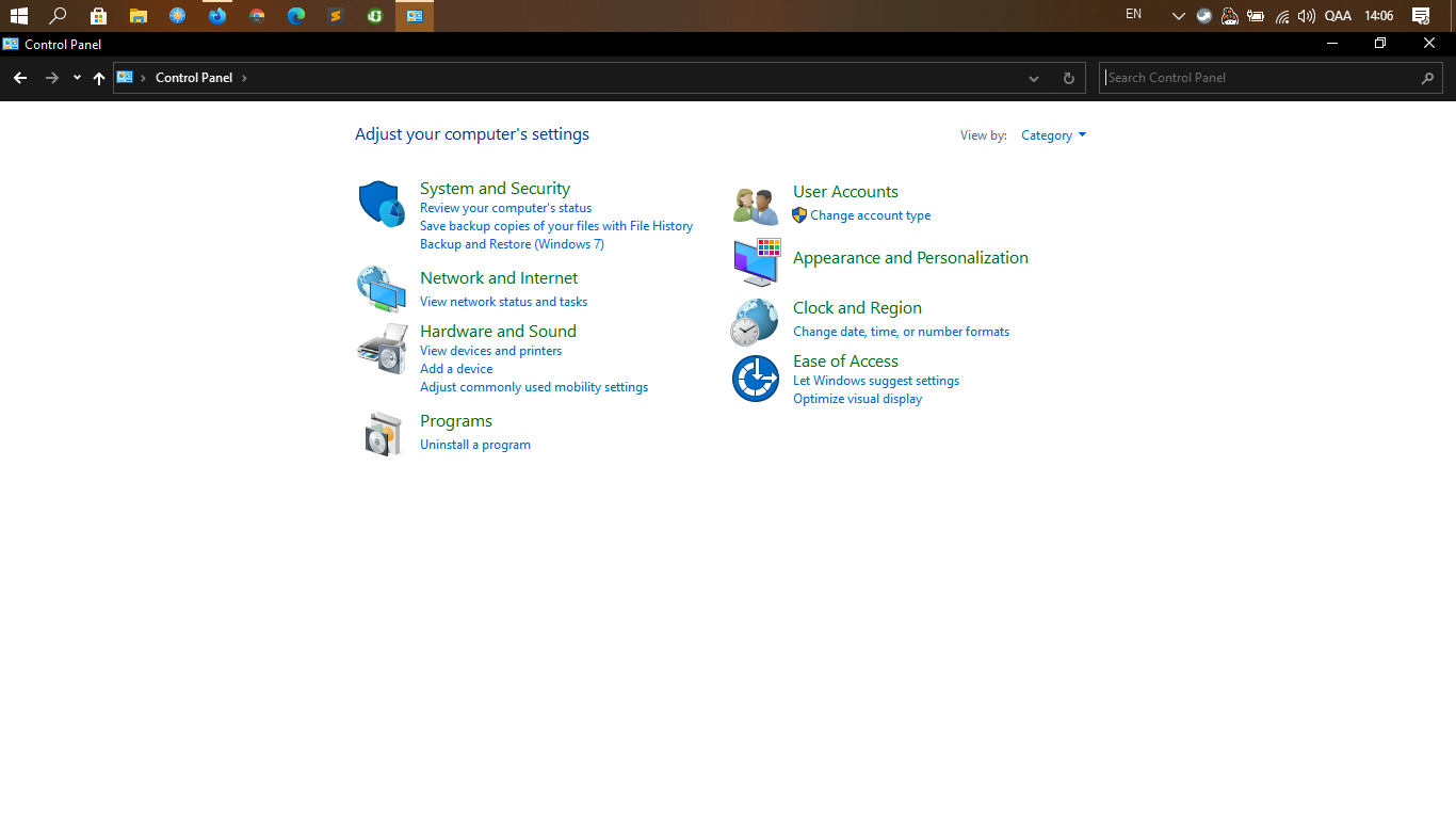

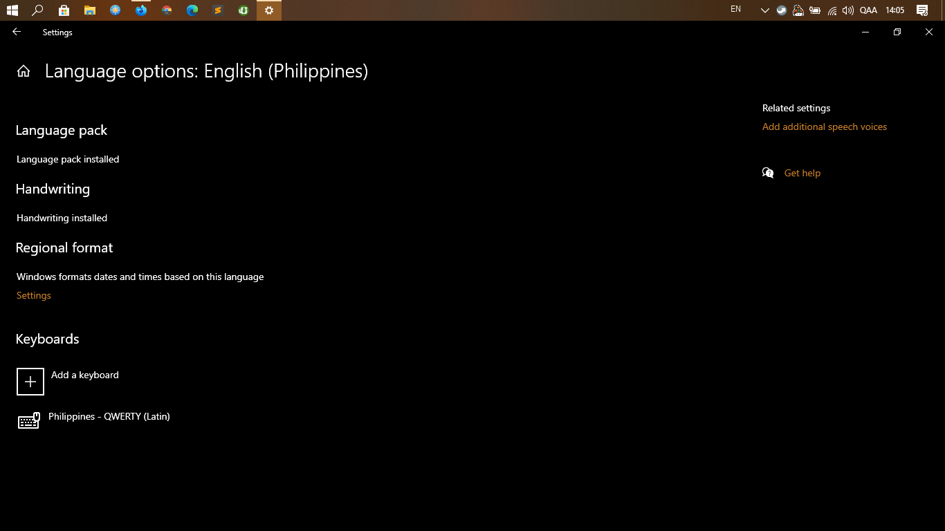

    As you can see from the screenshots of the settings, I only have three 3 Keyboard Layouts.
    1. EN English Philippines -- Philippines Unicode Keyboard Layout with ₱eso sign and other important Unicode characters not available in the obsolete ASCII-based US Keyboard Layouts
    2. FP Filipino Philippines -- Baybatin-Tagalog Unicode Keyboard Layout
    3. HE Hebrew Israel -- Phoenician/Paleo-Hebrew Unicode Keyboard Layout
    Yet, Windows 10 is showing other keyboard layouts that I can find where and how to remove. It's not in the traditional Control Panel > Uninstall Programs nor in Microsoft Store.
    I want these unwanted Keyboard Layouts removed because it is messing up the keyboard layout cycle when I am typing.
    Last but definitely not the least, how do you remove that Windows 10 taskbar "three-letter" language code? The original Language Bar two-letter language code is far better in detecting and displaying Keyboard Layouts as can be seen in the screenshots above.
    Thank you very much.
