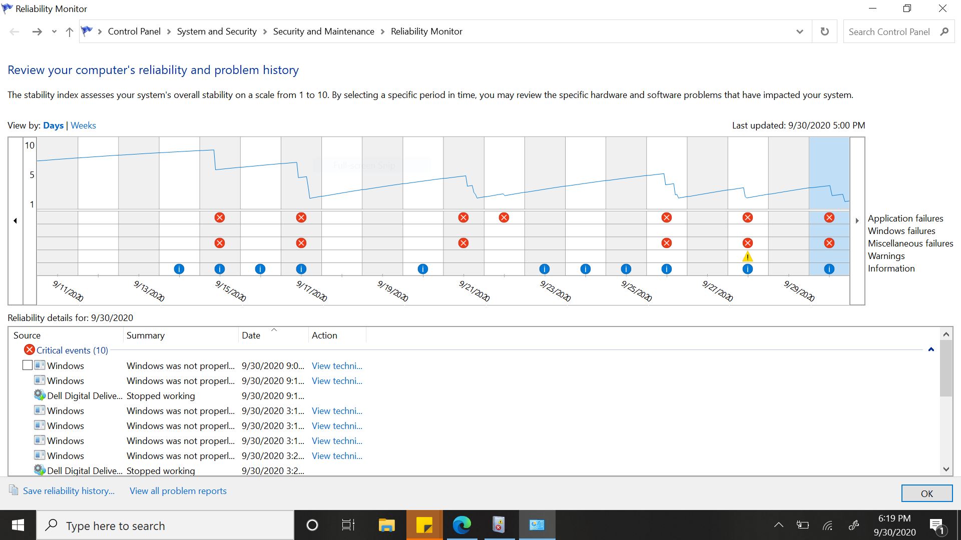

    I have two issues and I'm wondering if they are related. My computer randomly shuts down when I am just browsing on Bing. The screen goes black and the fan stops. I press the power button to turn it back on and it goes to the factory lock screen and is no longer connected to the internet.
    The other problem that I'm having is with my charger; sometimes when I am plugged in, the laptop does not register as charging. I think it is a problem with the connection at the port because when I rotate the cord, the white charging light comes on.
    I have a Dell Inspiron 7370 and I ran a few tests:
    Reliability history shows "windows was not properly shut down" at the times when the computer shutdown today.
    Power difficulties & Windows not properly shutting down f48c9887-5cdd-496f-9c3d-51687ff65a8b?upload=true.jpg

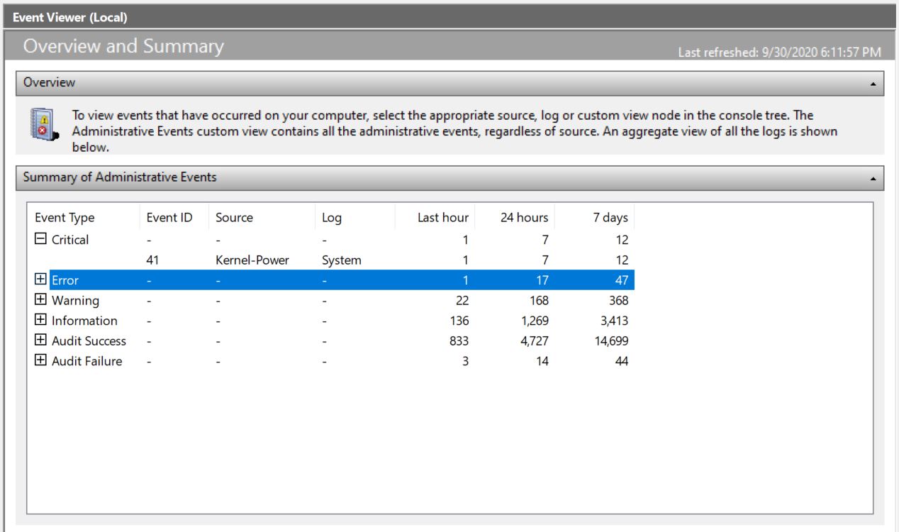

    And error viewer shows an issue with the 41 kernel-power which I think is related to charging.
    Power difficulties & Windows not properly shutting down 11a2e279-e7e2-420c-af39-2c301cb5964d?upload=true.jpg
    Please advise me on what other tests to run and how to prevent this random shutting down. Also, should I purchase a new charger? mine is 1 year old
    SarCru, Sep 30, 2020
