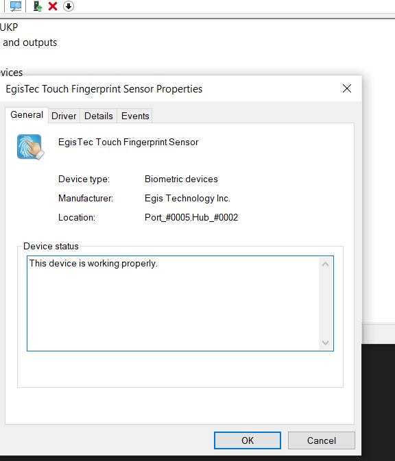

    Power Management issue in fingerprint 603cb516-848f-449e-a145-71e64940feeb?upload=true.png I have been facing this problem, after I turn on my laptop after sleep I cannot login using fingerprint. Although I can use my fingerprint after a complete shutdown. I guess this is a power management issue but i cannot find the missing power management tab in fingerprint driver in my device manager. I have been through many instruction and topics to restore the tab non of which were a proper help. I would love to have a solution, this is bothering me a lot because I normally let my laptop in sleep mode rather than turning it off. Thank you.

    It's odd for your fingerprint not to work after your computer wakes up from sleep mode. The power management settings could have something to do with it. Let's isolate your concern by modifying the power management through Device Manager. Simply follow the
    steps below:
    • Right-click on the Windows icon on your computer, then select
      Device Manager.
    • locate your fingerprint reader, it should be in Biometric Devices section.
    • Right click the fingerprint reader, then choose Properties.
    • Navigate to Power Management tab, then uncheck Allow the computer to turn off this device to save power.
    • Click OK.
