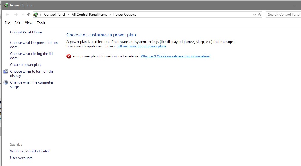

  1. Power Plans
    I recently did a Fresh Start on my HP laptop as I was having issues with Windows Defender and my computer was running slow despite my best efforts to fix it. The install solved the problems I was having with Windows Defender and speed but I have been having issues with the power settings ever since. The option to select the power plans are gone and it will not allow me to use the Command Prompt to reset the schemes, manually install them, or find their location (if they even exist).
    I am running the current update of Windows 10 Home (1809).

    This issue could have occurred due to incorrect Power settings. Try the steps listed here:
    Method 1:
    Let’s run the power troubleshooter and check if that helps.
    a. Press Windows key on the keyboard.
    b. In the search box, type Troubleshooting and press
    Enter.
    c. Click on ‘System and Security’ and click on ‘Power’ click on next to run the troubleshooter.
    Method 2:
    If the issue persists, I suggest you to
    restore the power plans to default and check if it helps.
    Step 1: Reset and restore the power plans to default:
    • Right-click on
      Start button
      and click on Command Prompt (Admin).
    • In the command prompt, type powercfg –restoredefaultschemes
      and hit Enter.
    • Exit command prompt.
    Note: This would reset the power plan settings to default. Any customized power plans are would be removed.
    Step 2:
    Once the power plan is reset to default, you may create a
    new power plan
    and customize the same according to your needs.
    Refer to the link:
    Power plans: Frequently asked questions
    http://windows.microsoft.com/en-us/windows-8/power-plans-faq
    Note: Applies to Windows 10.
    Hope this information helps. Reply to the post with an updated status of the issue so that we can assist you further.
