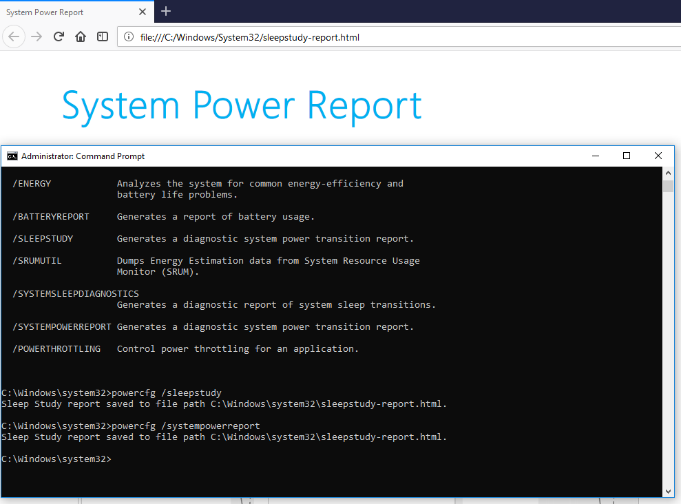

    powercfg /sleepstudy and /systempowerreport
    Powercfg option /sleepstudy generates System Power Report, and /systempowerreport output filename is wrong.
    command: powercfg /sleepstudy
    description: Generates a diagnostic system power
    transition report.
    output: sleepstudy-report.html
    report title: System Power Report
    command: powercfg /systempowerreport
    system power transition report.
    powercfg /sleepstudy and /systempowerreport produce identical reports i.e.,... 9bd5e860-da04-4026-8bc6-c16ff4bd9d39?upload=true.png
    jurluk, Aug 4, 2022
