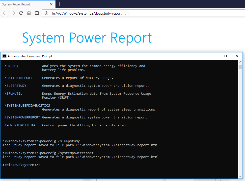

    powercfg /sleepstudy and /systempowerreport
    Powercfg option /sleepstudy generates System Power Report, and /systempowerreport output filename is wrong.
    command: powercfg /sleepstudy
    description: Generates a diagnostic system power
    transition report.
    output: sleepstudy-report.html
    report title: System Power Report
    command: powercfg /systempowerreport
    system power transition report.
