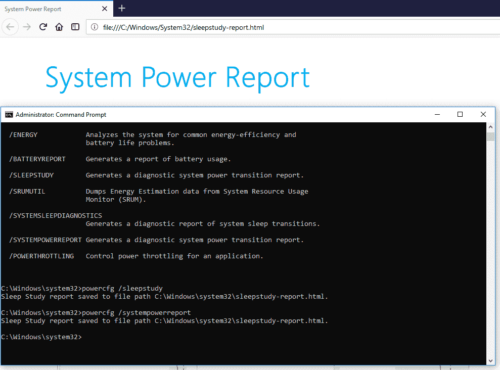

  1. jurluk Win User
    powercfg /sleepstudy and /systempowerreport
    Powercfg option /sleepstudy generates System Power Report, and /systempowerreport output filename is wrong.
    command: powercfg /sleepstudy
    description: Generates a diagnostic system power transition report.
    output: sleepstudy-report.html
    report title: System Power Report
    command: powercfg /systempowerreport
    powercfg /sleepstudy and /systempowerreport 9bd5e860-da04-4026-8bc6-c16ff4bd9d39?upload=true.png

  2. jurluk Win User
    transition report.
    jurluk, Nov 7, 2018
  3. the kernel power has initiated a shutdown
    Open an admin command prompt and run powercfg /systempowerreport . See if the report gives any more clues on what is triggering it.
    Code:
    Code:
    PS C:\> powercfg /systempowerreport Sleep Study report saved to file path C:\sleepstudy-report.html. PS C:\>
    powercfg /sleepstudy and /systempowerreport [​IMG]
    PolarNettles, Nov 7, 2018
