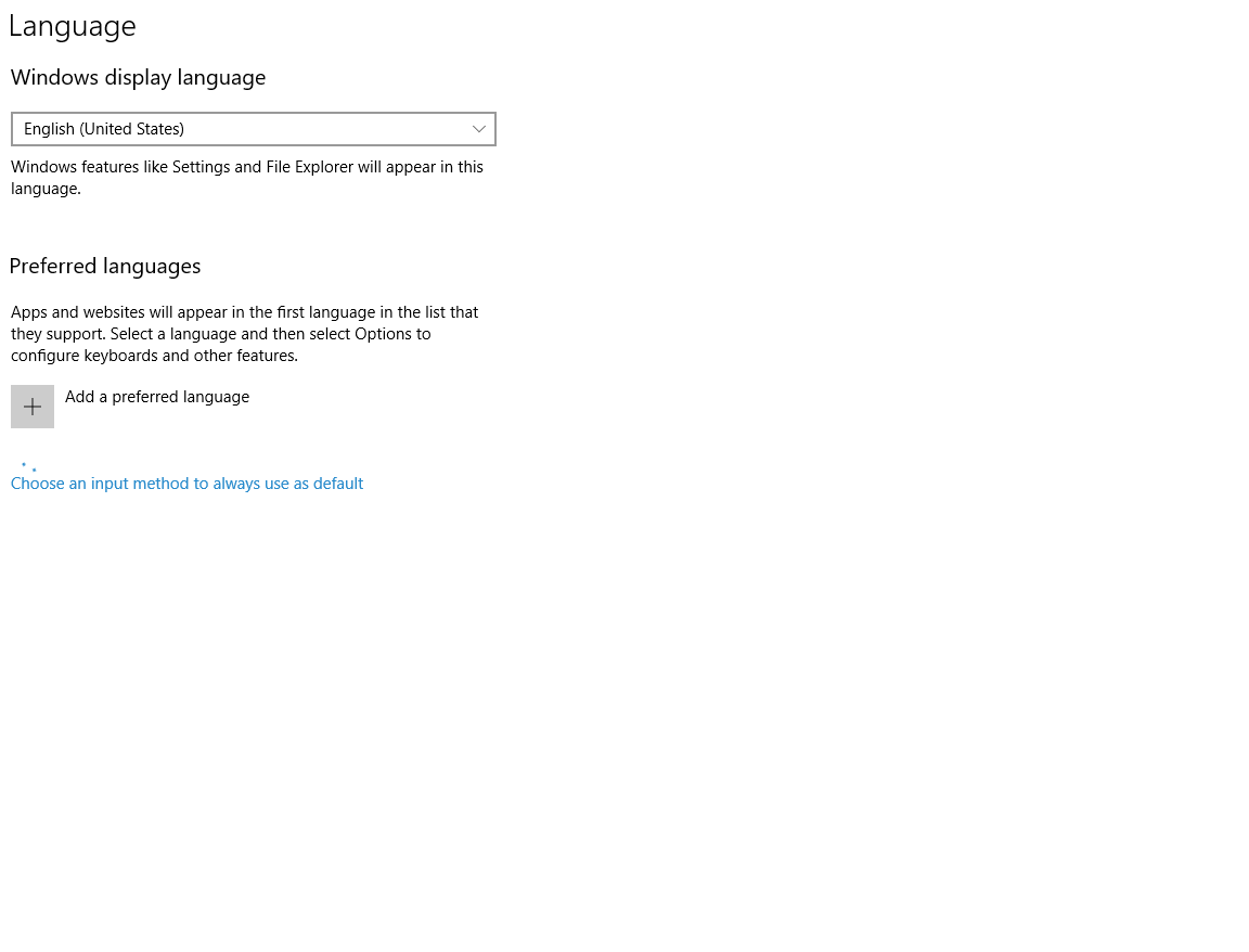

    Preferred language bug
    The loading of preferred language is infinitely, so i was unable to add/remove a preferred language
    If i click on "Choose an input method always use as default", it will become lagging and i need to force close it.
    ksgoh, Apr 6, 2021

  3. languages preferred
    Assuming you want to use English (United States) as your preferred language, try these steps
    1. Right click Start Button or press Windows + X keys and select Windows PowerShell (Admin).
    2. In the administrative Windows PowerShell window, type these commands one-by-one and press Enter key after each:
    Get-WinUserLanguageList
    This will display list of installed languages on your machine. Note the LanguageTag for your preferred language.
    $1=New-WinUserLanguageList <LanguageTag>
    Replace <LanguageTag> for your preferred language. For example, if your preferred language is English (United States), then you can use $1=New-WinUserLanguageList en-US.
    Set-WinUserLanguageList $1
    After this, when opted, type Y to confirm setting preferred language. Close Windows PowerShell and you're done.
    Hope this helps!
    Kapil Arya [Directly], Apr 6, 2021
