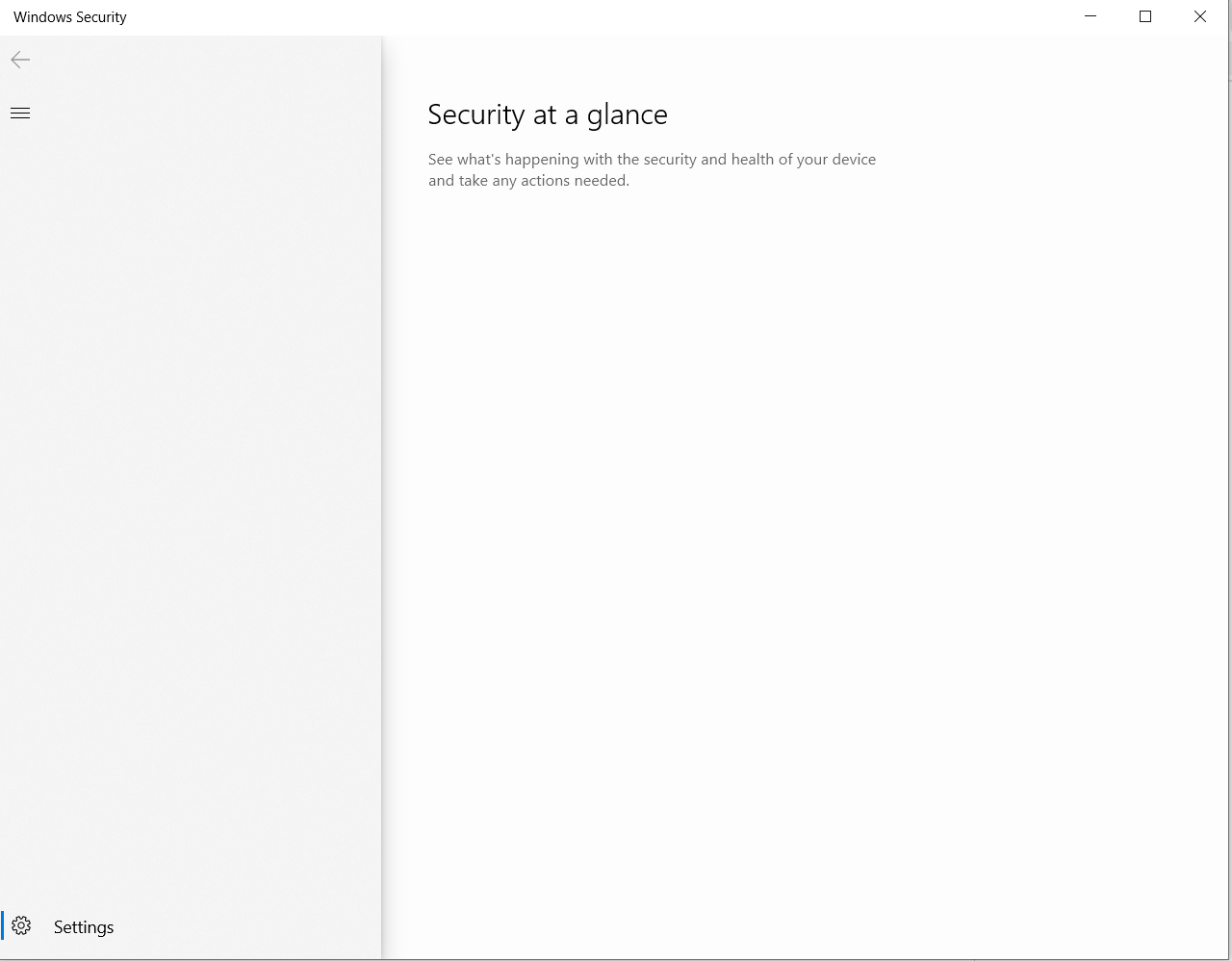

    Since, last week I am having a problem regarding my windows defender. It is not showing anything the whole screen has gone blank just leaving the two lines. When I checked on net others were having this problem too. I followed the solutions recommended to them. Most of them suggested to go with repair upgrade since my windows defenderwindefend was missing actually a malware has deleted it. So, first I scanned my PC with malware bytes. After that I started my repair upgrade using ISO file. But after doing some configurations it says :
    "This PC can't be upgraded to Windows 10.
    Your PC settings aren't supported yet on this version of Windows 10. Microsoft is working to support your settings soon. No action is needed. Windows Update will offer this version of Windows 10 automatically when these settings are supported."
    and give me options to either back or refreshwhich doesn't work.
    I have Windows 10 Home US Version: 1909 OS build: 18363.900.
    # I have uninstalled the party antivirus before starting repair upgrade.
    #In Setting on clicking to check windows update it shows error: "There were some problems installing updates, but we'll try again later. If you keep seeing this and want to search the web or contact support for information, this may help: 0x80080005"

    For now, I suggest that you perform repair in-place upgrade on the current operating system, this will just fixes/ repairs the issues with any corrupted system files and will not restore any lost data prior to this.
    In-place upgrade is to repair the current state of your operating system. Also, the issues with built-in apps on Windows 10 would be fixed when you perform the repair.
    Refer: How
    to: perform a repair upgrade using the Windows 10 ISO file
    by
    Andre Da Costa and check if it helps.
    Also refer to: Reset your PC
    Hope the information helps. Keep us posted on Windows related queries and we will be happy to assist you further.

    In place upgrade repairs and Windows upgrades cannot be performed successfully while in safe mode.
    Instead perform upgrades while in clean boot.
    Once you have ran through the steps in the upgrade check list then perform an upgrade in clean boot using the Windows 10 iso.
    It may be successful after running through the check list.
    If not it should generate the better error code.
    Panther logs can be scanned to see if there are focused troubleshooting steps.
