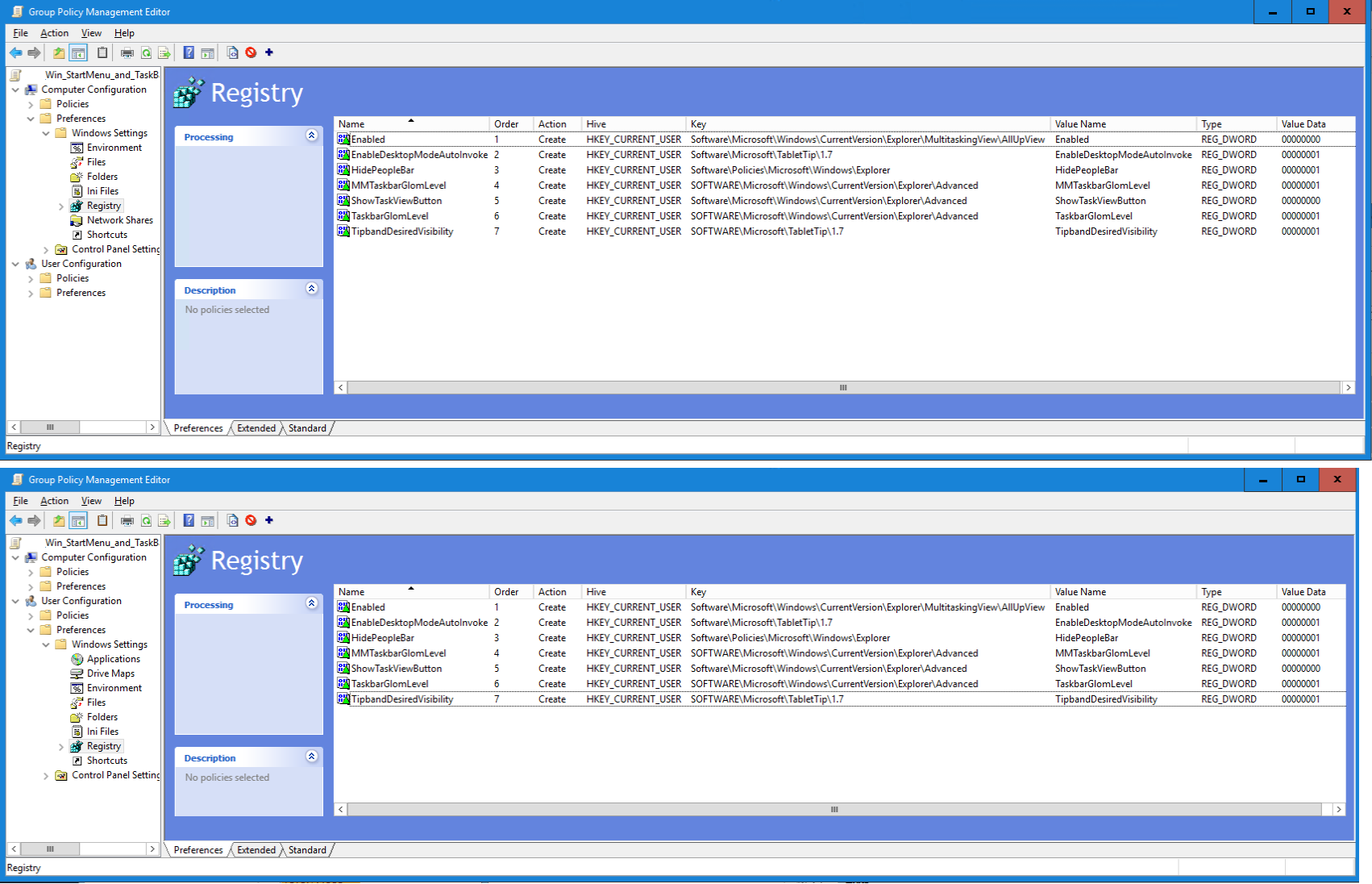

    Some of my GPO rules stopped working and I do not know why. I tried to google solution but without success.
    I have some Workstations/PCs with Windows 10 in one subdomain and I need to manage them via this registry rules.
    The problem is, that the my GPO rules are updating some items in registry in HKCU tree and it doesn't want to create items in HKCU.
    But it looks, that the GPO's with registry items for HKLM tree still working. I made a little test. I created a GPO with new registry item forHKLM tree in registry, this one was created.
    This is list of some HKCU registry items in which I need to create:
    Problem with appliing Registry GPO's for Windows 10 PC's 7f23367f-2142-4884-8068-d81c7c80dda6?upload=true.png
    For sure I made same config for "User Configuration" and also "Computer Configuration" I know, it's not necessary.

    • Software\Microsoft\Windows\CurrentVersion\Explorer\MultitaskingView\AllUpView\Enabled=0 - Remove Task View Button from Context Menu and Taskbar
    • EnableDesktopModeAutoInvoke - Turn On Automatically Show Touch Keyboard when No Keyboard Attached.
    • HidePeopleBar - Disable People Bar on Taskbar.
    • ShowTaskViewButton - Hide Task View Button on Taskbar.
    • TaskbarGlomLevel - Never Combine Taskbar Buttons Change Buttons on Main Taskbar.
    • MMTaskbarGlomLevel - Never Combine Taskbar Buttons Change Buttons on Other Taskbars.
    • TipbandDesiredVisibility - Show Touch Keyboard Button on Taskbar.

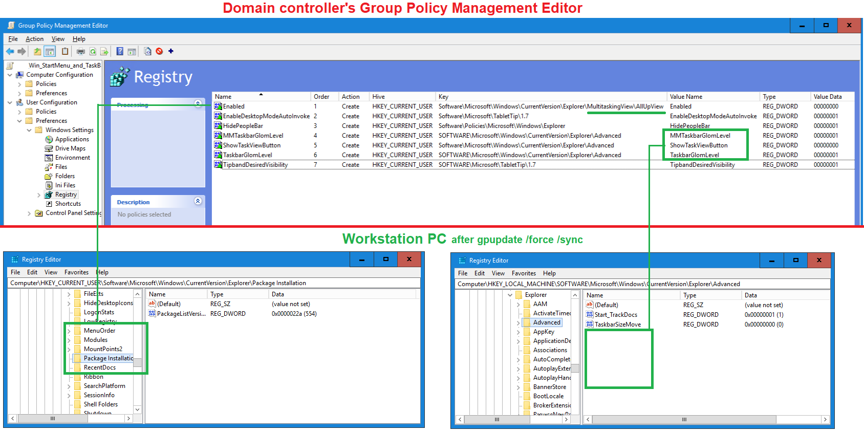

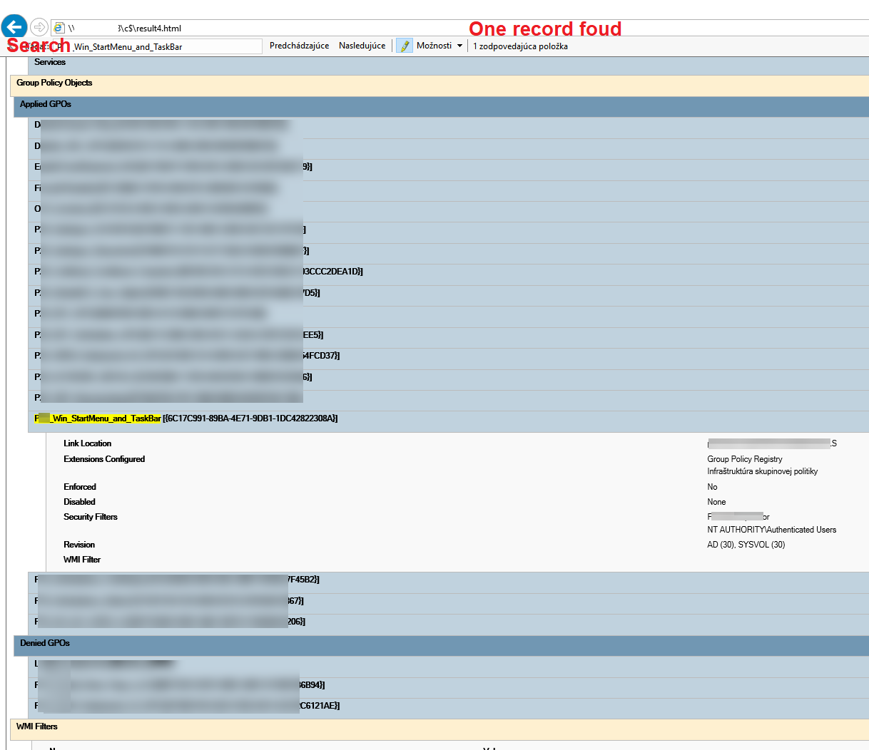

    On the Workstation I made "gpupdate /force /sync".
    After reboot I made "gpresult /h c:\result.html" and there I found info, that the my GPO Win_StartMenu_and_TaskBar was applied. But, I expanded all records in result.html and there was no other info about what from my GPO was applied.
    Problem with appliing Registry GPO's for Windows 10 PC's 533eef8d-fe8d-4d67-8dde-99b19dd55bf1?upload=true.png
    For sure I opened Regedit.exe on Workstation and there was nothing changed.
    I made screen of some non changed registry items:
    Problem with appliing Registry GPO's for Windows 10 PC's 85032466-db44-4789-a8e1-a0dcb4d05459?upload=true.png
    I tested it one two different PC's with same HW and SW.

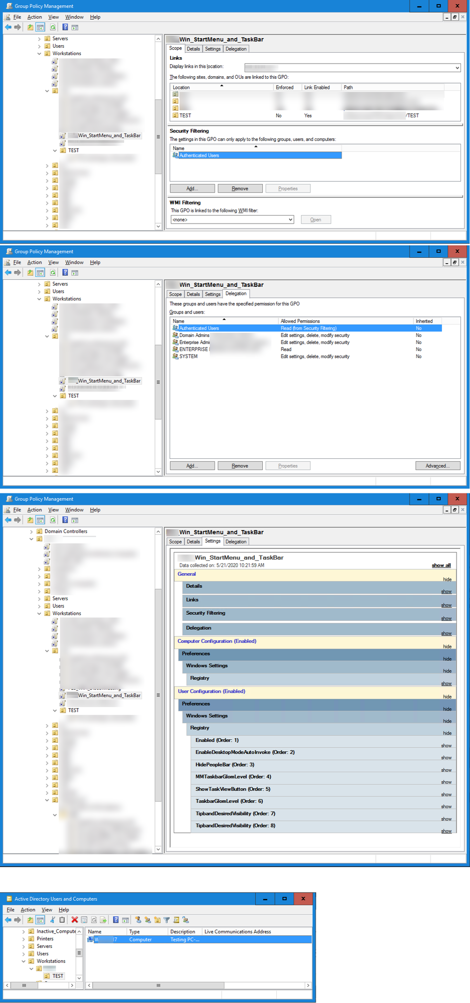

    Workstations and GPO rule are in the same OU. Workstaion user has a right to read GPO.
    Problem with appliing Registry GPO's for Windows 10 PC's c50eda56-d517-4c1e-874b-e6ac08776c6d?upload=true.png
    Please, have someone idea how fix this problem with apply change in HKCU Registry via GPO?
