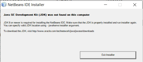

    I have installed Java 13 but now I m getting problem with running netbeans.
    Problem with uninstalling netbeans 8.2 and 8.1 3363123e-1b92-4b8c-a3a9-18f62edb0c76?upload=true.jpg
    I tried to uninstall it but I am getting error message:
    Java SE development kit not found on this machine.
    I have attached the image also:
    Problem with uninstalling netbeans 8.2 and 8.1 35e2d217-0445-4bb9-9fae-7c5ac108f8ce?upload=true.png
    But java SE is installed on my machine. I can see it through control panel:
    Problem with uninstalling netbeans 8.2 and 8.1 1968d310-1413-4d6c-9f09-63ad36a2bb5e?upload=true.jpg
    Both javac and java are executing om my system:

    I have windows 10 pro installed on my system
    Some body please guide me how to remove NetBeans8.2 & 8.1 from my system .

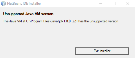

    Netbeans 8.2 unsupported Java VM version
    You need to install the 32-bit Java 8 VM. Netbeans 8.2 is a 32-bit application, it not compatiable with the 64-bit Java 8 VM, the error message is simply indicating this fact. However, if you are actually running Windows 10 32-bit, then I suspect the problem is due to the fact you have Java 8 Update 221 installed instead of an older version.
    If that is the case then I suggest just extracting Netbeans from the installer and installing it to the directory of your choice. The Netbeans 8.2 installer has not been updated in ages, and will never be updated, if it happens to be checking the version of the Java VM installed on the system.
    I strongly suggest you migrated to Apache NetBeans 11.1. Apache Netbeans (Netbeans is no longer an Oracle project) does not even have an installer. In order to install it you extract it to the directory you want it to exist in. This is really the only thing that the Netbeans 8.2 installer actually did, other than check to see if Java was installed, which is the cause of the error you have recieved.
    After installation I executed Netbeans 8.2 but neither New Project or New File worked. So I figured out by Documentation that this version of Netbeans support at least JDK 8. So I repeated the process and installed JDK 8 version (precisely jdk1.8.0_221). Now all works fine and I can open new projects/files.
    I suspect you had the 32-bit Java 11 VM originally installed which is the reason Netbeans 8.2 intially launched. Due to the fact Netbeans does not organically look for Java 9+ you were not able to compile projects.
