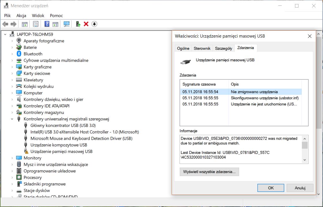

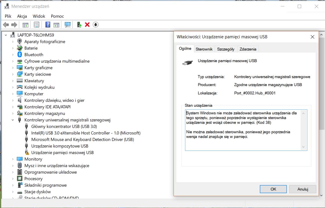

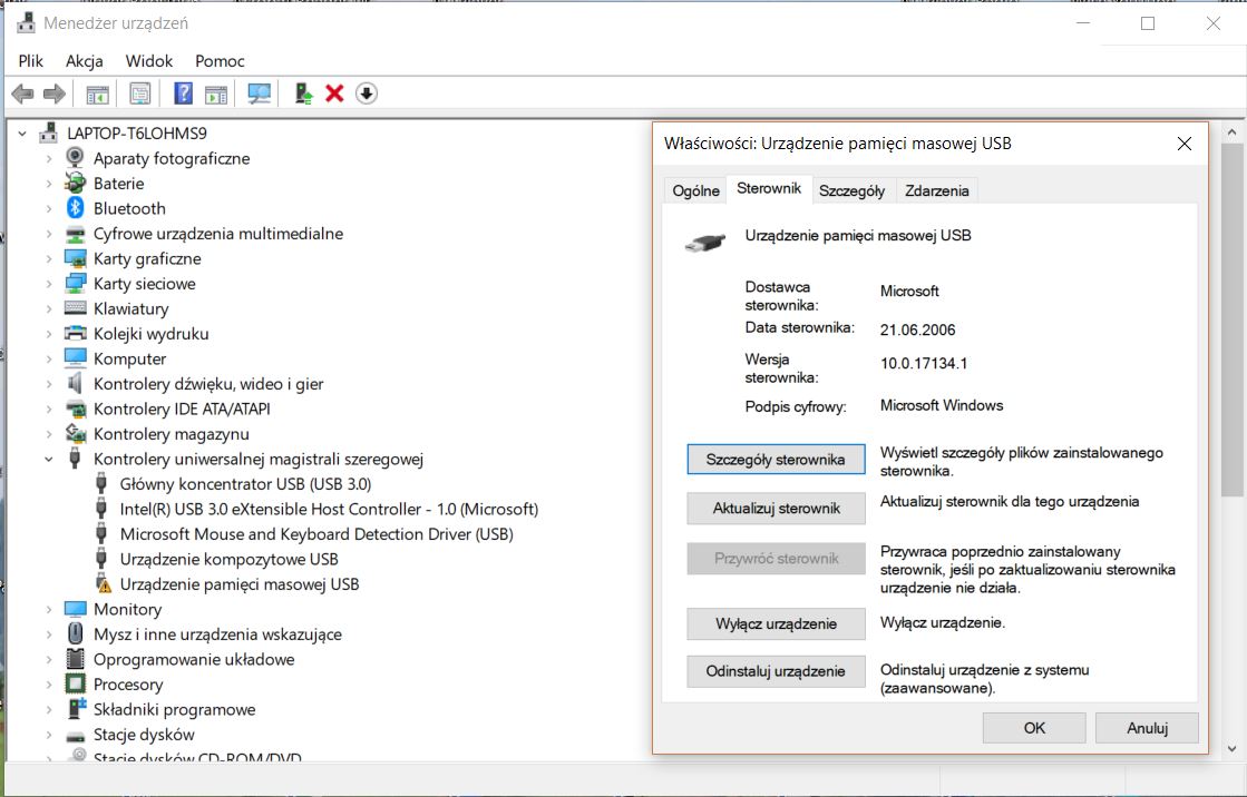

    I have a problem with the usb port expansions:
    1. Inserting usb devices (even directly after rebooting the laptop) with storage devices such as pendrive, usb hard drives means that either this device will be read correctly or not. It is completely accidental.
    2. When the storage device has not been read, then the message:
    The system can not load the driver for the device for this equipment because the previous device driver instance is still present in memory (Code 38).
    The driver can not be loaded because its previous version is still in memory.
    3. In contrast, if the storage device is connected to the usb port during a restart, then the device is correctly read.
    But there is an additional problem with the safe disconnection of such a device, because there is no option to safely disconnect the device.
    4. In connection with this, I have a request for help in resolving the abovementioned problems:
    - why the usb ports do not read the storage devices properly?
    - Why is the option of safe removal of the equipment inactive?
    5. In addition, I am sending screenshots regarding the above problems:
    Problem with Windows 10 USB ports cd9f2bcb-10f4-4783-9216-4929eb9f8333?upload=true.jpg
    Problem with Windows 10 USB ports 4cdfa7ee-b242-4070-9b1b-7ab6362fe064?upload=true.jpg
    Problem with Windows 10 USB ports df378e93-e0e2-4253-b81a-1667eab4a90d?upload=true.jpg

  3. spapakons Win User
    USB Port Oddities
    Ok, let's see it with pictures step-by-step. First right-click on the USB device and select Update driver software:
    Problem with Windows 10 USB ports [​IMG]
    Then select Browse my computer for driver software (LAST option) :
    The select Let me pick from a list of device drivers on my computer (LAST option) :
    Then select the standard driver from the list and click next:
    Click next/OK as required to complete installation. Repeat the steps for all Intel USB devices. Finally click on each USB root device and press DEL to delete it, reply YES when asked. After deleting all USB root devices restart the computer.
    I hope this is detailed enough...
    spapakons, Nov 7, 2018
