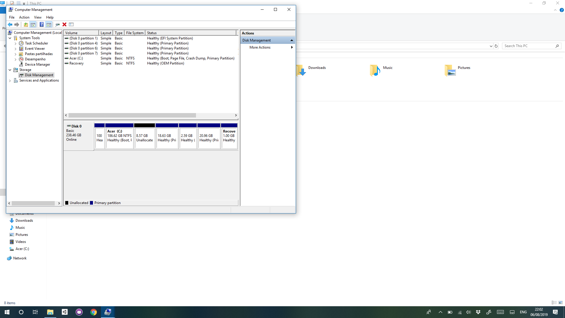

    I use both Windows and Linux in dual-boot, with windows being my primary operating system. This is a bit of a struggle because my laptop only has 256 GB of storage and I use a lot of apps during my day. I recently reached a point in Kubuntu where I'm out of space so I thought I would resize my partitions, which at the moment look like this:
    Problems with Partitioning a5799c73-2896-4ec2-84a1-6120139e0101?upload=true.png
    For some context, the partition named Acer is the one Windows uses, while the 8.57 GB that are Unallocated are the ones I want to combine with the 18.63 GB that Kubuntu uses, but it doesn't give me an option for that.
    I'd like to know if it is possible to do what I want to or if I'll just need to resize partitions when I uninstall Linux.
    GAL1lLE0, Aug 6, 2019

  4. dalchina Win User
    Windows 10 1709 System Restore problems...
    That seems to be an attempt at Option 2 in the tutorial, which requires you to
    a. Boot to a command prompt (Did you?)
    b. You then seem to be mixing steps 3,4 and 5, thus your command is incorrect.
    I suggest Option 1 is easier.
    If you still have problems, please repost listing each specific step and saying which option from the tutorial you are using. Thanks.
    dalchina, Aug 6, 2019
